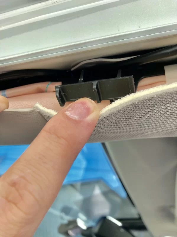

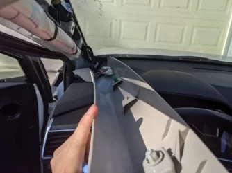

I got some feedback on this on my post on Reddit. It’s pretty tight and running the wires (for the hardwire line and the rear camera) behind the airbag is a bit tedious but it’s doable. I was rewiring my incorrectly wired install so I ran the cable from the door frame under the airbag toward the camera (not from the camera, under the airbag, toward the doorframe as I indicate in the instructions) and I managed to get it. The included cables have some chunky parts (ferrite core and the USB connectors themselves) that require some nudging to get through. I feel like coming from the other side (across the headliner to the pillar and under the airbag) would be an order of magnitude more difficult because visibility would be practically 0.
This is the best picture I could get of the wiring under the airbag at the seam between the headliner and the pillar of the driver’s side door:
Excuse my fingernail. The plastic in these parts is treacherous.

The problem with approach is that the wire passes in front of the airbag, so it might cause issues if it has to deploy...
The airbag is one piece that extends all the way form the dash to the rear seats. Page 9 of the emergency response guide:
https://techinfo.honda.com/rjanisis/pubs/web/AJA07616.pdf
So if you run it across the joint, it would interfere.
I asked the service manager about that and after the expected mandatory “we don’t recommend any modifications to any part of any Honda car...”, he shared this with me sub rosa.
The side curtain air bag covers both the front and back row so my power cable does in fact go over it. However there are two considerations that make it a moot point. First, the cable runs down the A pillar (after going over the airbag) under the gasket so it is easily pulled out by the explosion of the air bag initiator and has plenty of play so as not be a choke point. And mine plugs into the cam and can easily be ripped out by said explosion. So although he could not give it the Official Honda Good Housekeeping Seal of Approval, he said off the record, common sense says the way it’s routed vs. the way the airbag deploys is not a concern and he would be comfortable leaving it like it is. He mentioned the explosive force is going to rip off the trim pieces and headliner like they’re not even there. So pulling the wire out of the gasket with the opening facing in the direction of the pull coupled with the geometry means it’s not going to matter a bit. I was glad to hear that since I can be safe without having to do a lot of rework.

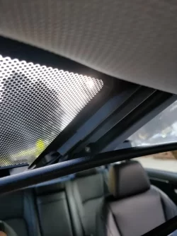

Quick question - any issues with using 3m tape for holders over the polka dot section of the windshield? I've been using a suction cup underneath this section, but wonder if the 3m tape could pull the dots out in the event I may need to remove the holder. My wife's Ody, the dots are embedded inside the windshield so no issues on using a suction cup there.
We need someone with a broken windshield to have the repair shop give them the dotted area so they can perform such tests.
Well, yeah.. but I'm sure someone else has done this before. All prior cars, the dots were inside the windshield itself so the area was glass. I don't like to 'stick' stuff if I'm not sure taking it out will cause problems. Like sticking stuff on the dashboard. I'm sure you can slowly take it out but chances are the are will get some sort of discoloration. In the case of the dots, I'm concerned these will come off.

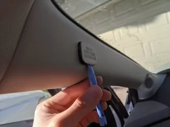

Best way to disable it is to disconnect the 12v and let the system shut off. The a pillar has a clip within the side airbag stamp. Pull that and the other clips pull out.

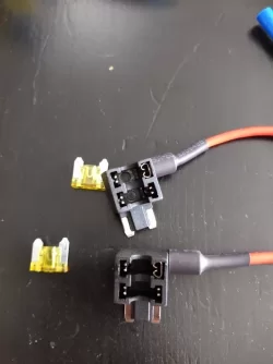

Going to be installing the Thinkware FA200, also want to use fuse slots 2 and 18 -- I don't have the car yet, what size are these? Regular, small, mini? I want to order the add-a-circuit ahead of time.

they are low-profile mini fuse iirc
