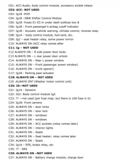

I copied this list from another post (another member) some months back when I installed my dashcam:
Thank you so much. Plenty of always on fuses.
Bryant

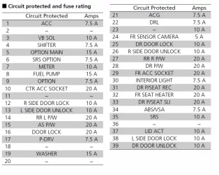

You might know that those aren't the interior fuses. Here is the fuse listing for the driver's side interior fuse box. You may want or need to run the wire into the engine compartment but I found the interior fuse box more convenient.
Tim

>>those aren't the interior fuses. (Tim, good catch, thanks!) I am always saving snap shots of prints, pics, lists, etc. from posts for later, but that was the wrong list.

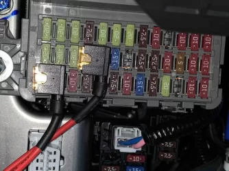

Here are pics from my Thinkware F800PRO install, so far so good. Rear facing camera in the window of the trunk lid, looking out rearward, and stuck on between defroster lines.
2018, Base model. The first number fuse for each row is stamped on the left edge of the fuse block (1, 14, 27). I think I used open slot fuse positions 2 and 18 as per earlier posts by others on this forum -

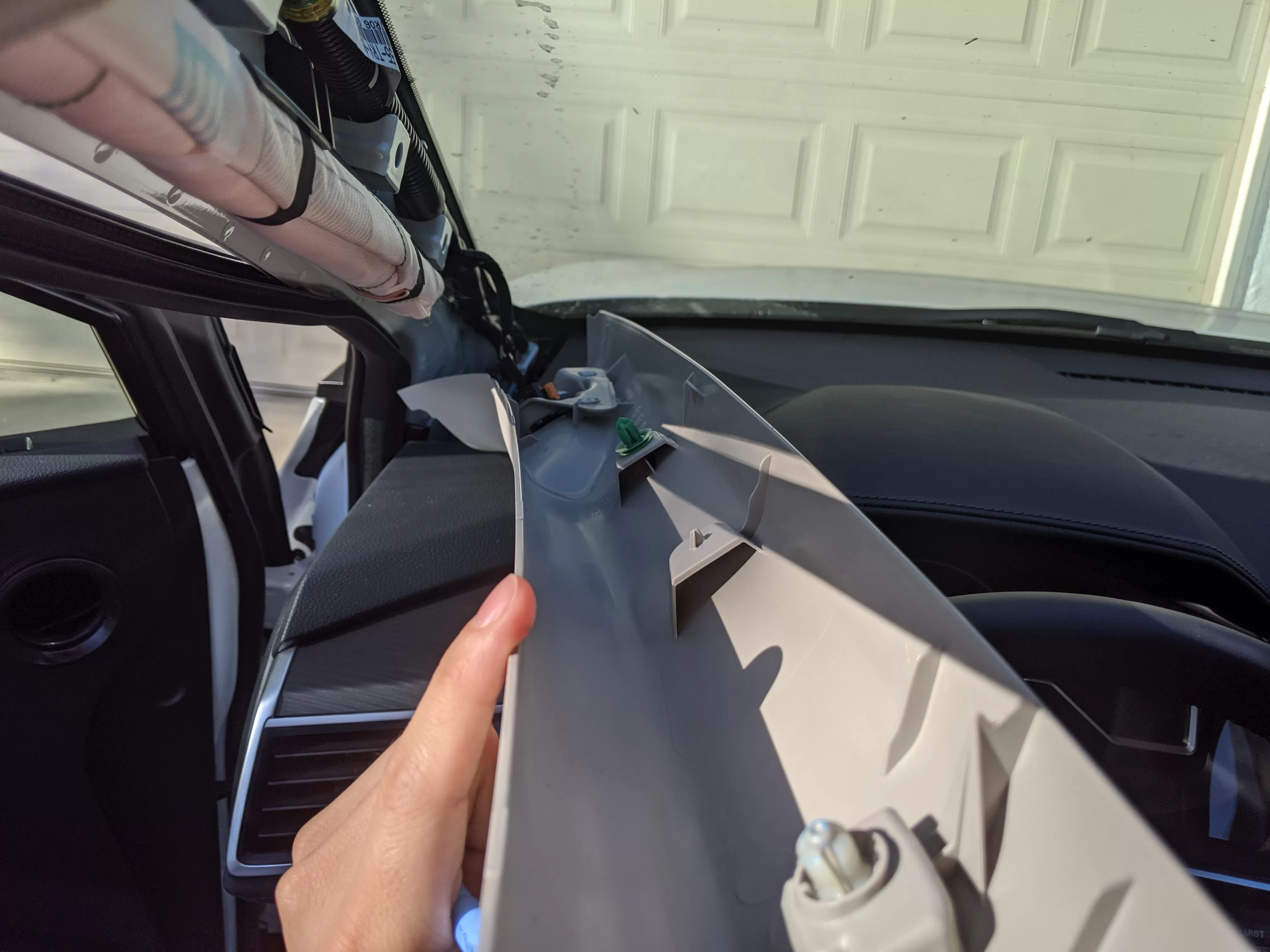

I think this is a common problem. Yeah I wish Honda did a better job at this. At least we can easily remove the A pillar panels without any damage and silence the rattles.

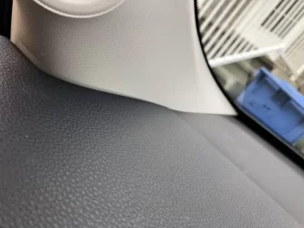

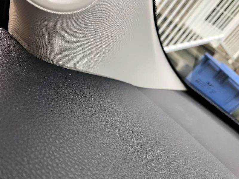

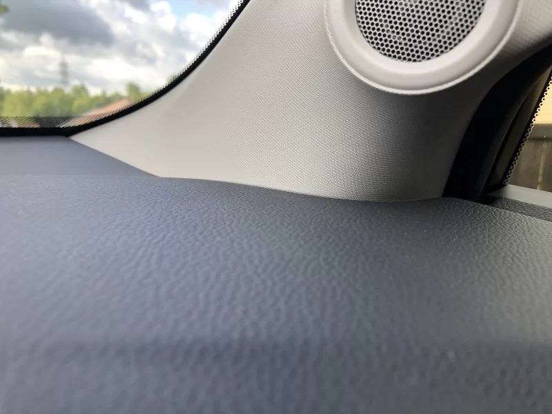

View attachment 5964 View attachment 5965 Am I thé only one who can’t reinstall the À pillar properly? See the photos.
This potential problem of damaging it or not being able to reinstall it correctly is why I left it in place and routed the wires past it at its top seam and then down the rubber gasket. This way it’s totally hidden without messing with the A pillar.

I think the potential of damaging is very minimal. Taking off the A-pillar is very simple, once you know how things look like inside.
I really like how cleanly it can be taken off. Pulling off the rubber weather strip is probably more of a concern, that it might rip apart if using a wrong tool. Putting it back together, you can look from the outside of the windshield making sure the two clips are in the right place.
I would redo the wiring while adding some anti-rattle sponge material on the A-pillar. The A-pillar has so much space to move around, that's why it doesn't sit flush and often times rattles if it's not treated. There's really only one clip that you pull off using force. The other clip comes off easily once you pull out the "airbag" square sign piece.

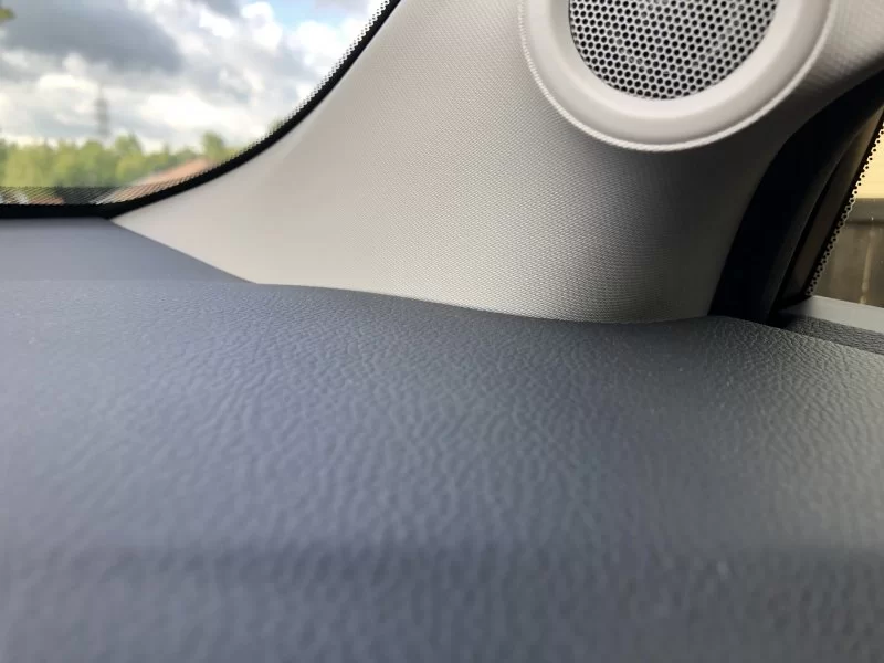

I don’t think my A pillar is broken - it’s just that it seems to be a bit short - I can clip it at the bottom, but then the 2 clips at the top fall under the holes that they are supposed to go in.
Alternatively, when I insert the top 2 clips, the bottom doesn’t reach far enough to go under the dash

If it's any consolation, nmy July build and my cousins May build clarity has the A-pillar that looks like that from the factory. I just pulled it off to hardwire my dashcam and it's seated the same way as yours. It looks to be as a bad mold more than installing incorrectly. Also, it seems I'm missing a green nub/clip for the center clip!
Thanks, I wouldn’t expect that from a Japanese car maker...
Thanks. I will reinspect immediately and have a trusted mechanic look at it.
Better safe than sorry.
Just take a picture before and after of you base of your A pillar. I wish I did as the poster above suggested it was manufacturing defect for some models, but now I don’t have the proof :(
There are people who have not removed their A pillar who say it is short. Mine was manufactured 11/18 and does not seem short, maybe they changed the part at some point? Or maybe there was a bad batch. If it can somehow be confirmed that a newer part will fix it then it is something you will want to get taken care of during the 3yr/36K warranty. OTOH I think I remember someone having the shop change the A pillar but it didn't solve it, but maybe the part they obtained was from an old batch.
Unless as I think someone else theorized the problem is actually with the dash installation. Hopefully that's not the case and it's just a matter of a batch of incorrectly manufactured A pillars.
