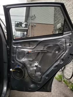

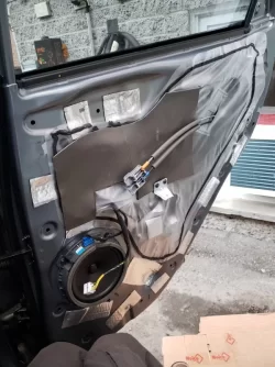

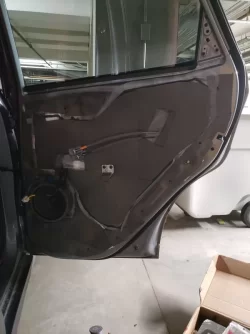

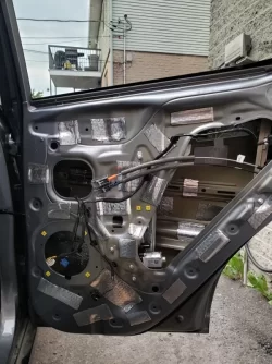

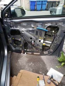

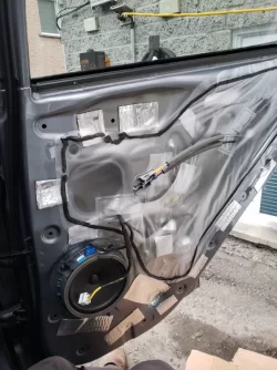

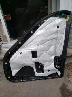

Rear right door done.

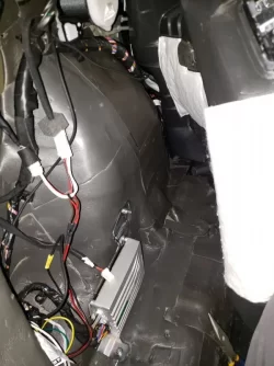

Last bit of the rear left wheel arch completely done.

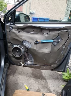

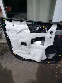

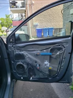

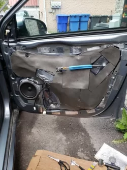

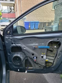

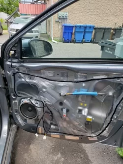

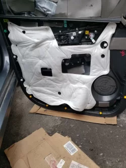

front right door done.

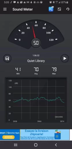

db has improve : -1 db less on average from both right doors done. Really satisfy.
The bad news : both right doors now insulated, has mask some sound coming from the back. :( Need to recheck it. Will be able to not be a driver next week and be able figure out from the rear side
What to do : the roof and near the firewall.
