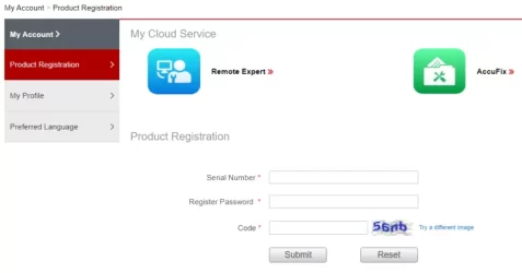

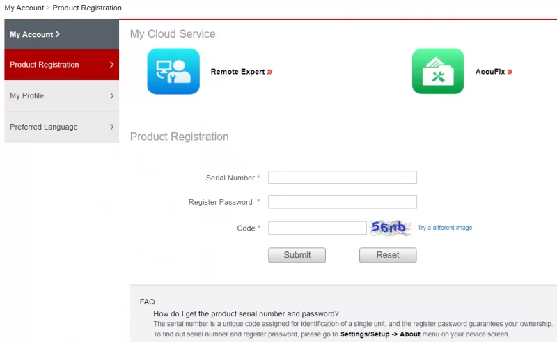

I got my AP200. How do I get the register password? I sent an email to support and they said that I need to register the device first. I plugged in the device and got it to connect to my phone and installed the Honda software. I don't see how to get the register password. It's not the same as my autel login. According to the screenshot, it says to go to Settings/Setup About but it doesn't show the password. Is this only for an Autel device with a screen? Is connecting the device with my login enough?
Never mind, there is no register password for this device but you need to login to the app and connect it to the device which is the registration. Do this before you send Autel the email.

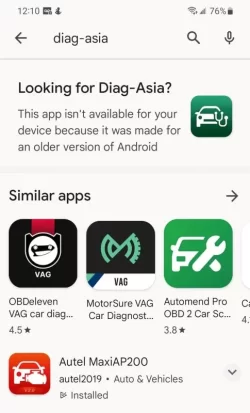

While I wait for my ap200 to be delivered I successfully installed the android app for it named "Autel MaxiAP200" but when I tried to install the "diag-asia" app for my Honda it said that that it "isn't available for my device because it was made for an older version of Android". I have a Samsung s22 that is 64 bit but has android 13. Could you tell me what version of android I need or if it will work on my version if obtained via the mall instead of the playstore?
Ugh, I dunno. The devices I have it on are both Android 12.
It surprises me if it isn't compatible with 13 but I have no experience.
Since this is a one time need for you (if it even works at all), I might suggest that you locate / borrow an older phone rather than try and fight the battle as to why it doesn't seem to be compatible with Android 13.
You could try and ask Autel but their tech support has been spotty at best.
That's strange. I have a current s23 ultra (android 13) and it's installed on mine
I opened a ticket with autel and they responded with:
Dear customer,
Thanks for contacting us. We have noticed this problem and will submit a new update to Google play, but it needs a few days. If it is urgent, please contact Google to get authorization to download first.
I'm not sure why I'm so unlucky cause it won't download on any of my families phones. The android 13 are Samsung s22+, s21fe, and a54. Android 12 is a TCL t767w. Will try a iphone13 this weekend but hoping for a google play update soon.
