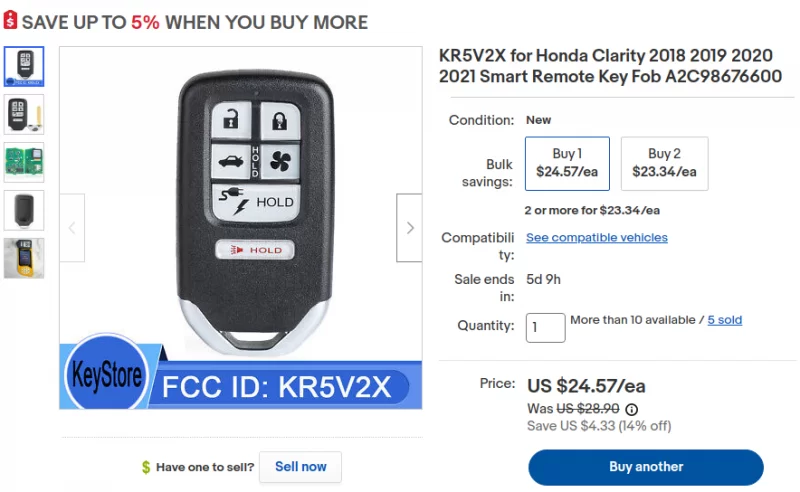

I am 99.99 % sure that there is no difference between the touring and base keyfobs. I say this not from direct experience, but because I am familiar with the process of how these keys function, and I do have experience with a non-oem fob and programming it onto the vehicle..
The bigger question is why?
I do not understand your desire to "have at least one oem key". I bought a keyfob on eBay some time ago, and programmed it into the vehicle per @lincomatic instructions. Not only does it work perfectly, but it is physically indistinguishable from the original fob. The quality is just as good. The only visible difference is the lack of a Honda logo. Also, the new non-oem fob comes with a blank mechanical key which you could have cut to match your vehicle. If you bought a used oem key, the mechanical key would not fit your vehicle.
Here is the fob that I bought...
One thing that may not be obvious... The keyfob does not get programmed. It is the vehicle that gets programmed to accept the fob. That is why you can do all of this through the vehicle's OBD2 connector.
So now the interesting question: Are the ebay keys all electronically identical, so that if you set your car to accept one ebay key, every other Clarity ebay key would work (modulo the rotating): that is, are the cheap ebay keys all coded with the same id, or are they (as the Honda ones) each "unique"...?

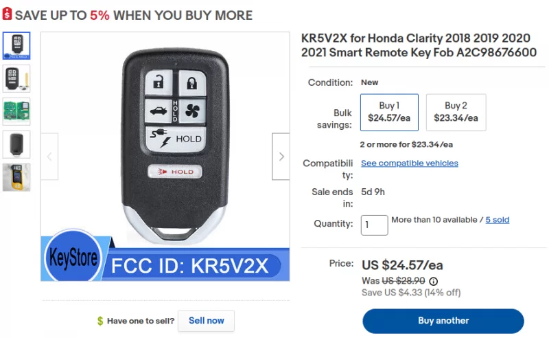

My one issue with the aftermarket key fobs is quality control. The aftermarket key fob I have has quite the quirk, it won’t unlock my car with the buttons. The lock button locks the car and the unlock button locks the car as well. All the other buttons and functions work fine except for that one button. With only being able to program so many keys I’d like to have at least one for sure good key.
I am not sure about this, but how do you know that the Honda keys are uniquely coded? By virtue of the rotating PRN code system, keys become unique even if they are identical to start with. I'm sure you have seen that there is a well-documented hack where a sophisticated attacker can electronically enter the vehicle by intercepting one code, then using brute force trial and error. The reality is that this method is much more complicated than breaking a window.
This is just a guess, but I think it is likely that the aftermarket keys are electrically identical to the Honda ones (could even be made by the same manufacturer). If the Honda keys have some unique coding, then the aftermarket ones probably do also. There is a good chance that neither the Honda or Aftermarket keys have unique coding and rely on the PRN sequencing to make them unique. The vehicles certainly have unique serialization so that may be used as part of the key registration process to make the PRN's unique even if the keys are not.
