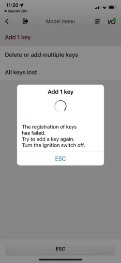

Thanks for this great info. However, it didn't work for me. I got to the step to "Add 1 Key", established comms and turned ignition on when prompted but then I got this error message. It didn't prompt me to remove other fobs from the car and gave me an error when I did that. Any thoughts?
Any thoughts?
I will let @lincomatic weigh in too, but I just wanted to propose a possibility.
Most of us with AP200 interfaces on this forum have been running with the Honda Diagnostics Beta version (2..01.54).
This is because it gave us access to the Electric Powertrain data which includes the HV battery capacity.
I know @lincomatic is running the beta version. What I do not know is whether the key registration would be expected to work with the non-beta.
Does your Honda diagnostics icon show 2.01.54 or is it something else?

Good catch! Mine is on 2.01. How do I get 2.01? I'm on the iOS version although I could use an Android device. Thanks!
Good catch! Mine is on 2.01. How do I get 2.01.54?
Note - This is speculation on my part, but it would be a reasonable thing to try unless @lincomatic has another thought.
If this turns out to be the answer, then it would be useful information for others too.

Ugh, after several messages back and forth, Autel finally admitted that the 2.01.54 beta is not available for iOS. It's not showing up on an old HTC One Android phone, which I think is 32 bit, so that may be an issue with the beta as well. They have not responded yet if an iOS version that programs key fobs is in the works. I sure wish Autel would be more honest and open about the actual capabilities of the device.
I told you above that it was NOT iOS compatible and that you needed a 64-bit Android device !!!

Whoa! I humbly ask for your forgiveness in not taking your "speculation" as gospel and getting a little confused about the absolute requirements, thinking the github reference was to a custom code solution for a battery capacity function. I try my best to absorb the information the best I can and am sorry I did not meet your expectations. I was taking the primary advice from Autel who stated unequivocally in their advertising that the device could program key fobs and in their tech support answer that the beta version would show up.
I saw no indication in the OP's message or in information from Autel that this would not work. (I'm certainly not blaming the OP for not mentioning the restriction since they were using android and were probably unaware of it.) Autel wasted a lot more of my time and money than I did theirs! Since I don't have access to a newer Android phone, I'll return the device if Autel is not releasing the feature for iOS.
BTW, I strongly suspect that the beta version is indeed necessary for the key fob functions since the functions and screenshots shown for the beta version in the OP's message are very different from the ones I see on any of my devices with v2.01.

FYI, from Autel support:
  • Sorry to tell you that we have no plan to develop ios beta version.
  • For adding a spare immobilizer key, please use IM devices, AP200 does not support.
