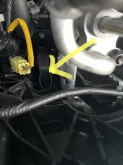

There is a slight gap right below the trunk opening latch and radiator in 2020 Niro EV. If look into this space, you will find VESS cable. Use a steel straw to push the cable lock which is facing towards radiator until you hear a click sound. that basically unlocks the cable. You can pull the cable right up to disconnect VESS. This took 2 minutes for me to disconnect. hope this helps.

I have a 2020 EX Premium. I "think" I see the connector but want to be sure. I made a quick video as to what I think I need to unplug. Is this correct?
It is the shown connector. You can use the straw kri mentioned above to unlatch it. I couldn't pull it up with the straw, but I was able to reach my hand in there and pull it up.

I tried looking for the wire on my 2022 Niro EV and can’t seem to locate it. Any chance you could take some better pictures of the location or maybe FaceTime to help me out? I looked at the video above and can’t seem to find a wire that looks the same. Tired of listening to that crap lol.

Disregard I figured it out. What helped me was disconnecting the radiator bolts and prying it away from the front plastic “frame”. Easily fit my hand in there after that. Also removed the hood latch assembly. I was looking downward in the radiator and not seeing the wire. Realized it was forward of the radiator reaching towards the Kia logo on the front bumper, in the 1” gap.
Pic of the radiator bolt to remove, one on each side.
