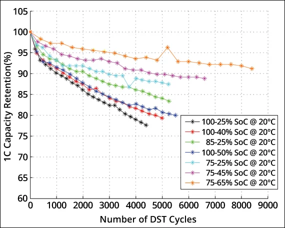

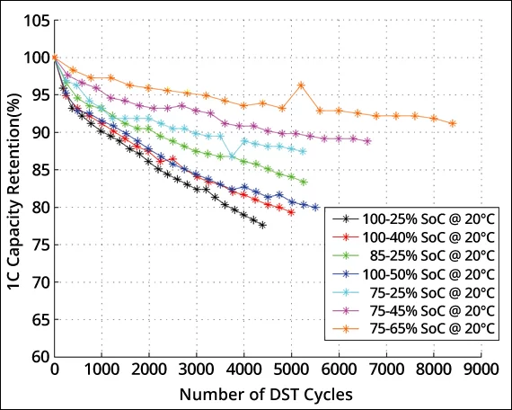

According to the Battery University of Canada (yes there is such a place) to make your battery to last the longest, keep it between 60 to 80%. That said, if you fast charged daily for each work day and discharged the battery fullyView attachment 15317 for 20 years, you would only lose 10% of your batteries capacity by year 20. At worst you will lose 25% of your range, but that is at 4500 cycles... most people do 100 cycles in a year of normal commuting. In short, it is pretty difficult to reduce the range of your vehicle. Studies also show that most people keep their vehicle 6 years. The battery is the least of your worries.
I notice that the chart is based on 20 degrees Celsius (68 F). Is there any information available on cycles in more extreme temperatures? People on this forum have been reporting their battery capacity Ah along with their miles and age of the car. It appears that several people have experienced about 9-12% loss of battery capacity in just the first two years of ownership, and usually well below 50,000 miles. They report the same decrease in actual driving range since they purchased the car, closely matching their Ah numbers, and this is not just seasonal variance due to cold temperatures.
They are the exception, but so far we really don't know why this happens to some people. I tend to doubt that charging method has much if anything to do with it, more likely something else like higher temperatures might be a contributor. Perhaps even just occasionally charging at high temperatures. Or maybe extremely low temperatures. Or a dozen other possibilities considering the huge number of variables between owners. Probably there isn't one single factor that affects everyone. Or maybe it's none of that and there are just some inconsistencies in manufacturing of the batteries. But "trust the engineers" doesn't seem like a satisfactory answer to give these people, unfortunately we really don't have anything to suggest to avoid this, or if there's nothing anyone can do and it's just luck of the draw.

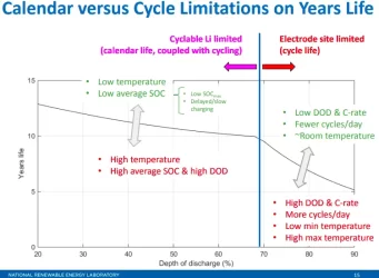

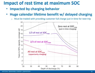

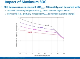

If one is motivated to reduce damage to the battery to extend its life there are some strategies to do so. It depends on a lot of things. If you have a commute that is long enough to fully deplete the EV battery every day, and you fully charge in between, then the impacts are more prominent on the electrodes within each battery cell, and charging at high or low temperatures (especially for our NCM cathode chemistry) induces more damage. As mentioned above the charging rate of L2 is still pretty mild and shouldn't be considered damaging. But in cases where the temperatures are very high or very low the BMS reduces the charging rate to limit any significant potential damage.
In situations where one has a short commute and can charge frequently, thus only having shallow cycles, then the overall damage is lessened, and the damage is more in the mobile lithium itself. Here again temperature plays a role in the damage potential, so on very cold or very hot days it may be advisable to avoid charging or even drive in HV if you want to reduce the potential to have irreversible capacity loss. As well, it is better to do the shallow cycles in the middle of the SOC range. So for instance at a 30% depth of discharge it is better to cycle between 40-70% SOC than 70-100%. Here are some plots from NREL (from computer models based on years of empirical vehicle EV data):
Another helpful strategy is to not leave the battery always resting at very high charge state. Thus if you need to fully charge it is better to plan it so that the full charge completes just before you intend to use the car. Here is a plot that shows the potential damage impacts.
I am not suggesting 'worry', 'concern', or 'agonizing' over the need to 'baby the battery'. I don't lose any sleep thinking about my battery. But I do avoid things that can cause irreversible damage when it is reasonably possible to do so. To each his own.
If you are interested there is a good youtube video that explains the damage:
