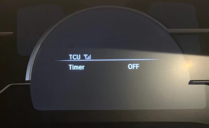

You can Check the cellular signal in your garage by observing the dash display at shutdown. The first thing it shows you is TCU and an antenna symbol with the cellular signal strength and underneath is your car’s charge timer state.

Based on what I'm seeing (attached file) the signal couldn't be much better. And of course when I tested turning on climate just now, it worked perfectly. Thank you for fixing my problem.
As you can see, my Timer says "Off". what is my "car's charge time state" and how do I change it from "off"? (Sorry to hijack the thread.)

No prob. Was supposed to say “timer state”. The off just tells you you have not set up any charging schedule on the car. Useful to verify so you don’t have any problems public charging or like me that you’re free to set up a charging schedule on your home EVSE which is easier to me. You can change this in settings to take advantage of lower rates if offered by your utility.
Looks like you have 3 of 5 bars signal strength which one would expect would be enough. I’ve got 4 of 5. If you have continued problems connecting, you might try resetting the head unit (hold down audio button) or reinstalling the phone app. Also, make sure you have the correct app for the Clarity, but if you are connecting sometimes you probably have the right one. As a last resort you could try disconnecting the negative battery terminal, but then you will lose settings and range estimates will start from scratch. Let us know your progress.

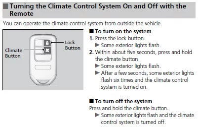

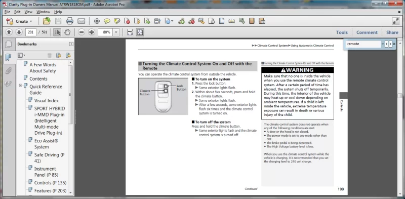

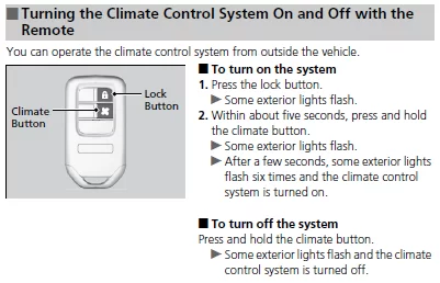

I have only been able to get this to work once. And that was with the car’s key fob. Is there a special way to manually turn “on” the car, while connected to a level 1 evse, and charging is complete from overnight but still plugged in?
You haven't. The fob only turns on charging, not climate.
you can precondition car with level 1 charger as long as charging is done( i.e. like a cold morning) and the cord is still attached. It will precondition and then start charging to keep full.
Charging does not need to be done (100%). You can PC the car even when you are not 100%, you just need to turn off charging first then you can turn on PC. IF the charge cord is still plugged in, charging will start after PC is ON. Charging stop automatically if PC is turn off (manually or after 30 minutes)
Use the app to turn it on
I used it for scheduled PC for the first time this morning and it worked like a charm. Fantastic feature.
I totally forgot that. I even looked at my fob before posting and blindly ignored that fan button... :(
I'm pretty sure you need to lock from the fob before remote "start" will work, but perhaps I'm just carrying that over from the previous two SUVs we owned.
