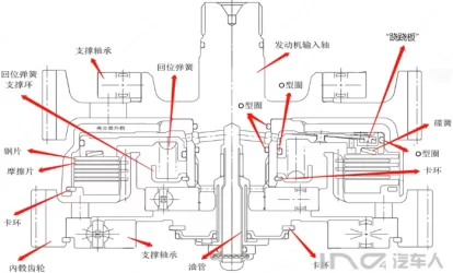

Honda specifies DW-1 transmission fluid for the Clarity PHEV. This the same fluid is specified for the Honda non-CVT automatic transmissions since well before the turn of the century. Honda automatic transmissions differ from just about all others. Most older automatic transmissions use planetary gears and bands. Honda automatic transmissions have gear clusters like manual transmissions with disc clutches instead of syncro cones and engagement teeth. DW-1 is party formulated to work with these wet disc clutches. The Clarity PHEV has a similar wet clutch to engage the direct drive mode. I suspect that is why the Clarity uses DW-1. Honda does have a new transmission fluid for its pure EV cars. These cars do not have wet disc clutches as there are no uses for such. This fluid is not specified foe the Clarity PHEV.
Using any regular automatic transmission in a Honda automatic transmission is not a good idea, especially for the CVT transmissions for which honda has a CVT fluid. I think that the Honda engineers know what they are doing and the transmission fluid specification is not at all based on cost considerations.

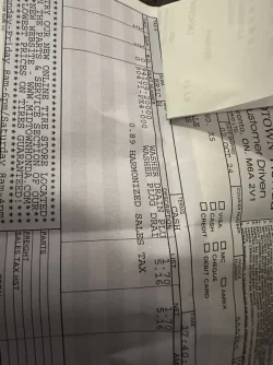

Casey, does the 17 mm fill/overflow bolt have a crush washer that needs to be replaced? If yes do you happen to know the part number? I checked multiple Honda genuine parts websites and I could not find this 17 mm bolt in any of the Honda Clarity parts diagrams.
I just got both crush washers yesterday- here they are:
Did you mean to show us the crush washers? I'm curious why one costs so much more than the other.
yes, someone asked for part n.
One cost so much more most likely because one is slightly bigger, or maybe because it’s Honda, and they just assign such small costs using random numbers generator.
In fact, I just finished the flush, and discovered that my car had both washers of the same size. They are quite close in size, and two bigger ones will work as well.
