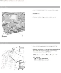

I change the transmission fluid in my Clarity Plug In every second oil change. So roughly every 15k miles I change it. It is fairly easy to do. Remove the 17mm fill plug. Remove the drain plug using a 3/8 socket wrench. Allow all the fluid to drain out. Change the crush gaskets on both the drain and fill plugs. Reinstall the drain plug. Pump fluid into the fill hole until fluid leaks out. You can buy a hand pump that threads right onto the bottle of Honda DW-1 Fluid. You will need three quarts of fluid but it will only take a bit over two quarts to fill it. The total you need according to Honda is 2.23 quarts. Reinstall the fill plug and you are done. On a lift I can do it in about 15 minutes. I do it more often than recommended because it is cheap and easy to do. Since it holds such as small amount of fluid I believe changing it more often is good idea. I have 102k miles on my Clarity now and so far no issues with the drivetrain.
Edit: I don't use the fill plug that the person in the video in post #11 does. On the drivers side of the transmission there is a 17mm bolt that you can remove to fill the transmission by pumping the fluid up into it. Once it is full it will start to run out like filling a differential. This is the way Honda recommends doing it as well. I work for a Honda dealer but I am not a technician. I attached a photo from Honda showing how it is suppose to be done. I am not saying you can't fill it the way the video shows in post #11. That will work as well but I would recommend you remove the drain plug to get all the fluid out. Then be sure to only fill it with the proper amount. You don't want to overfill it. Doing it the way Honda recommends you can't overfill since it comes pouring out once it is full.

a bit overkill, no?
Interesting that on the diagram it says “Non-Honda ATF will affect shift quality” - it is just a gearbox, no shifting there.
I agree, maybe a little excessive... Although there is no 'shifting', there is a multiple disk wet clutch inside that is used for 'engine drive' mode. A wet clutch could be subject to the particular characteristics of the fluid that is used.
My philosophy is that there is that there is nothing to be gained by using non-Honda fluid. If if is just cost that motivates you, it uses so little fluid and so infrequently that any cost savings will be trivial. Sticking with the manufacturer recommendations just seems prudent to me.

...I attached a photo from Honda showing how it is suppose to be done. I am not saying you can't fill it the way the video shows in post #11. That will work as well but I would recommend you remove the drain plug to get all the fluid out. Then be sure to only fill it with the proper amount. You don't want to overfill it. Doing it the way Honda recommends you can't overfill since it comes pouring out once it is full.
