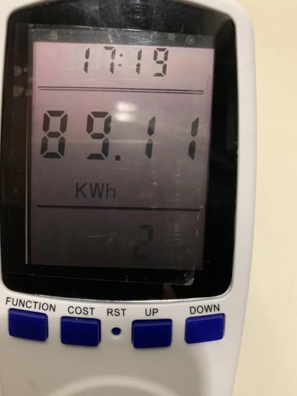

I installed the kilowatt meter yesterday and will let it accrue for a month.
You should get a pretty good idea of the results after a day or two. If you are using $100 of electricity in a month, it would be $3 per day - 30 kwh per day... If you are less than 20 per day, you have not found the problem.

Mid-month update. 89 KWh so far.
