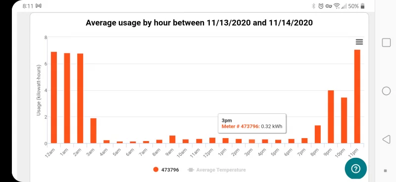

Is not on your bill, check your online account. My online account lets me see my usage hourly in the pic below. I have tier pricing, $0.15/kWh between 6-8am and 3-8pm, $0.05/kWh at other times with a $12 monthly fee. So my average last month with taxes and fees was $0.071/kWh.
