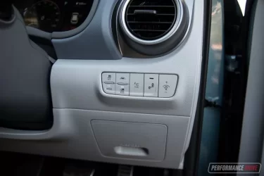

Vince08; you wrote that you turned the VESS off; How is that done?
As I wrote before, VESS is ON , even in Drive= N. But if you put parking brake ON ("P), VESS noise stops.
My Asian spec Kona comes with a VESS button on the dash. Here is an image of the VESS button taken from the Internet.
