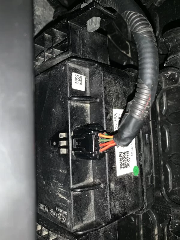

Classic example of why the radar sensors supersede the VESS sound (which is very quite form a pedestrian point of view) :

I heard a VESS yesterday while walking in town and knew immediately that it was a Kona, only the second time in 8 months that I've seen one drive by. It's certainly louder outside the car.
