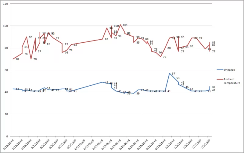

bought ours 12/17 and now have 20K miles- getting 59 EV miles this summer
Our summer battery level in 2018 was 48-53 miles of range. In April of this year, as the weather warmed, the range was increasing then suddenly fell and is averaging only ...

I had all five TSBs (18-089, 18-090, 18-091, 18-096 and 18-097) applied in May and I am getting about the same EV range on a full charge -- in the high 50's -- as I recall getting last summer.
I haven't been using A/C, so the theory in another thread that TSB 18-090 might reduce EV mileage with A/C use wouldn't contradict what I'm seeing.
I'm getting mid 50s of summer EV range at approximately 13k miles and I think I have the software updates. I had around 60 the first summer before the update.
At one and a half years and ~10,000 miles, I’m getting 62 to 64 EV miles on the GOM and at least 60 actual but I seldom let the charge deplete to 0.
That’s in temps 70 to 90 F with AC, one person, local 55 mph max and about 50:50 hwy/city in Econ.

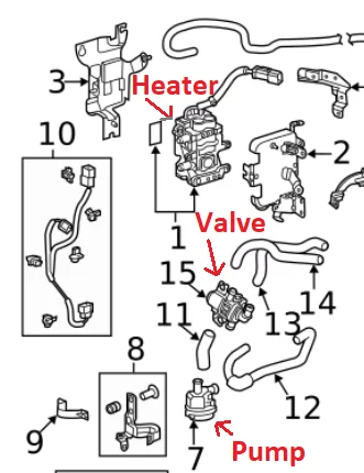

This may be a dumb thought, but what if your resistant heater is not completely shutting off. That would mean the AC would need to work harder and the heater as we all know burns a lot of power. One thing you could try since it is summer, would be to remove the fuse to the resistant heater and see if your mileage increases.
Anybody know the location of a fuse to shut off the resistance heater?

Maybe the heater is drawing power straight from the HV battery? In that case, we won't be able to unplug the fuse. The fuse will be HV energized and can be serviced by technicians only.
B18 seems relevant, but it controls A/C too. B17/B19 seems suspicious, what is "ES" water pump?
I guess that means nobody knows where that fuse might be...
I had looked at that diagram before, and came up with the same questions.
It was suggested to 'remove the fuse' so I thought I had missed some new information.
It would be really nice to 'deactivate' the heater during summer months. I get the impression it is also used for dehumidifying. I would love to investigate that, but I cannot even get a reading of the amperage/power used in the heater.
The resistance heater is clearly not running off the 12v system....heck I’ve seen it draw as much as 4500 watts in preconditioning mode off my level 2 charger if memory serves from winter. If that were running off the 12v system the math says it would need to be protected by a 375 amp or larger fuse!
More likely a big circuit breaker is protecting the resistance heater wiring, which is running off the traction battery. My strong recommendation is don’t mess with it and forget the idea. Accept the car for what it is.
And no amount of heat does anything for dehumidification. Cold coils from the AC remove moisture in summer. Heat does not.
Obviously I can’t prove anything but I find it highly unlikely the resistance heater would ever come on during a time that the climate control is not calling for heat to be added to the cabin. If cold air is coming out of the vents, the heater is off and not contributing to battery drain.

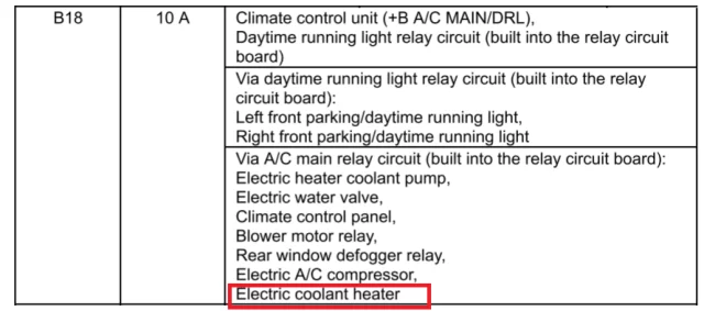

Fuse B18. The last item in the list for that fuse "Electric coolant heater"

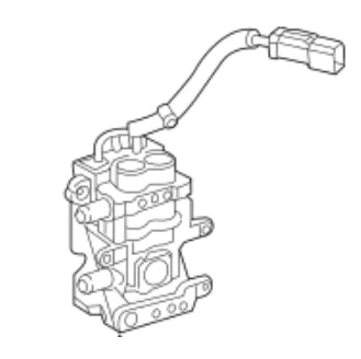

The pump for the coolant heater is on the same list, shown as "Electric Heater Coolant Pump", as is the valve, shown as "Electric Water Valve".

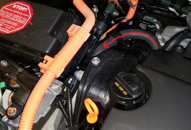

If you want to see where the coolant heater is located it's just behind the oil fill cap. If you follow the coolant hose indicated by the red arrow in this photo which is coming from the cabin, the hose goes to the top hose connection of the coolant heater.
The heater would be more efficient if it was located in the cabin but I guess since it is on a high voltage circuit they had to locate it in the engine compartment.
