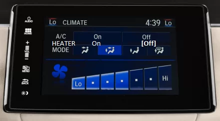

Hey, does everyone else's Climate Control screen shows AC is not ON and not OFF? Is this a bug that's been fixed? When I first go to Climate Control, it doesn't show whether it's on or off. Also, yeah, it would be wishful thinking if Honda add at least another row of Heater ON OFF control. They should have treated the AC and Heater as equal energy consumers instead of thinking heat is free.
Yes, mine works the same way. Press climate button and neither on or off is lit on the screen.
Yes, mine too. I think that if you’re in auto mode neither indicates. You only see On or Off if you manually select them. I sometimes manually turn off AC and set the temp to Low to get outside air with no AC or heat. They must have just copied the gas-mobile system without taking the effort to make it EV friendly.
