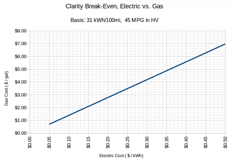

I will double check by putting a meter on the plug of the charging cord the next time I do a full charge but I believe a charge from "empty" 2 bars on a 120 volt cord is about 14 WK. Remember the battery never fully depletes to prolong the battery life.
I was going to ask about that -- I understand the battery is marketed as 17kWh, but unless Honda actually put a higher capacity physical battery, they have to be basing the 47 mile electric range on the usable portion of the battery (i.e. from "charging stops" to "car stops running in EV-only mode"), which is probably closer to 14-15kWh. That would put EV driving at 45/15 (to make the math easier!) or 3.0 miles/kWh. Anyone with a cumulative kWh display on their
EVSE should be able to measure their actual MPkWh over a few trip types to get the real number.
Similarly, you have to measure your MPG, which is harder to do on a plug-in hybrid, but can be done in HV mode or by filling up when the EV range is 0, driving a few trips, and filling up again.
If we assume 40MPG on gas, at $3/gallon that should be $.075/mile. Electricity assuming 3.0MPkWh at $.225/kWh cost would also be $.075/mile.
Disclaimer: I don't have a Clarity yet (need to test drive and decide whether I want to go that way or a more "fun" manual transmission Civic), but find these threads very helpful and have been running numbers myself. Lucky to have a reasonable rate here for overnight charging ($.10/kWh); in fact anything except 5-8PM weekdays ($.28/kWh then) might still be a win for charging.
