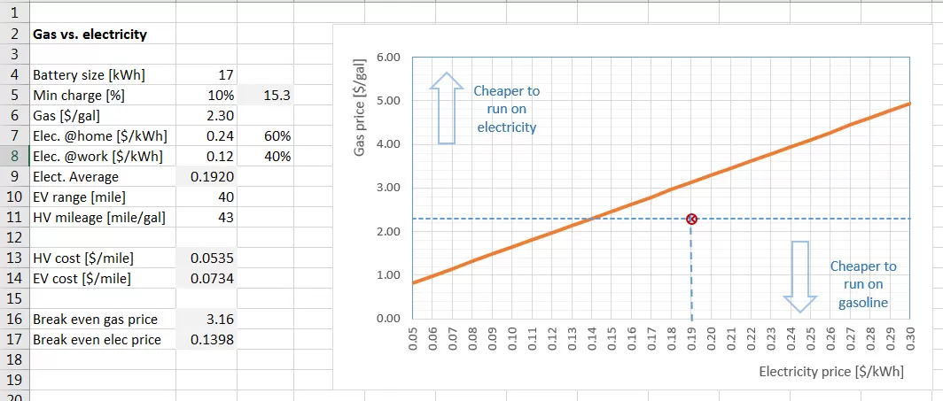

Has anyone figured out the Electric/Gas $ break even point for the Clarity?

Yes, I agree that this number is power into the vehicle, miles out (losses included). Of course, the break-even is entirely dependent on what you assume for these numbers (the 31 kWh / 100 mi, and the 45 MPG in HV). Obviously individuals drive differently and conditions vary. Personally, I have found that my actual experience has been very close to these assumptions. Certainly close enough to get a very good idea as to 'Break-even'
When I look at what a battery fill-up is from empty (mine average 13.72 kWh) I traveled as few as 31.9 miles when the temps were 11 degrees F to 58 miles in summer. So much of the calculation depends on weather, summer range. So just use the formula izudin posted and you can figure out your break even which will change by season mostly based on your EV miles and of course the moving cost of gasoline. Some really good posts here thanks all.
If anybody interested I can send them an Excel file to play with the numbers.
Thanks all for the replies. I think the two key numbers are miles/kwh, and MPG. According to Marshall's numbers, those are 3.225 miles/kwh, and 45 mpg. Are those what people are really getting? I'm guessing those are numbers and moderate temperatures? If those are at moderate temperatures, then when it's 30F outside like today, I would think the the miles/kwh would be moderately lower, 2.5 maybe, and the MPG would be slightly lower, 40 mpg? If that's the case, then in frigid weather, my cost to go 100 miles in EV would be .20 x 100 /2.5 = $8.00 vs. HV 100 / 40 x 2.29 = $5.72! Is that right? I think my math may be bad here.

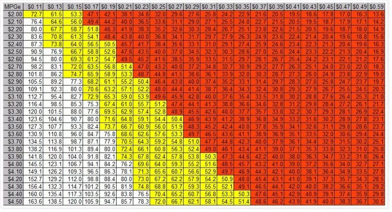

Here cute chart from about 4 years ago. Find your MPGe in the middle and see where the kWh price crossed the gas price. Really shows paying $.39/kWh at Blink is never worth it unless the alternative is walking home.
Thanks for providing the link to your spreadsheet ! It can clearly be tailored to whatever a user would like.
