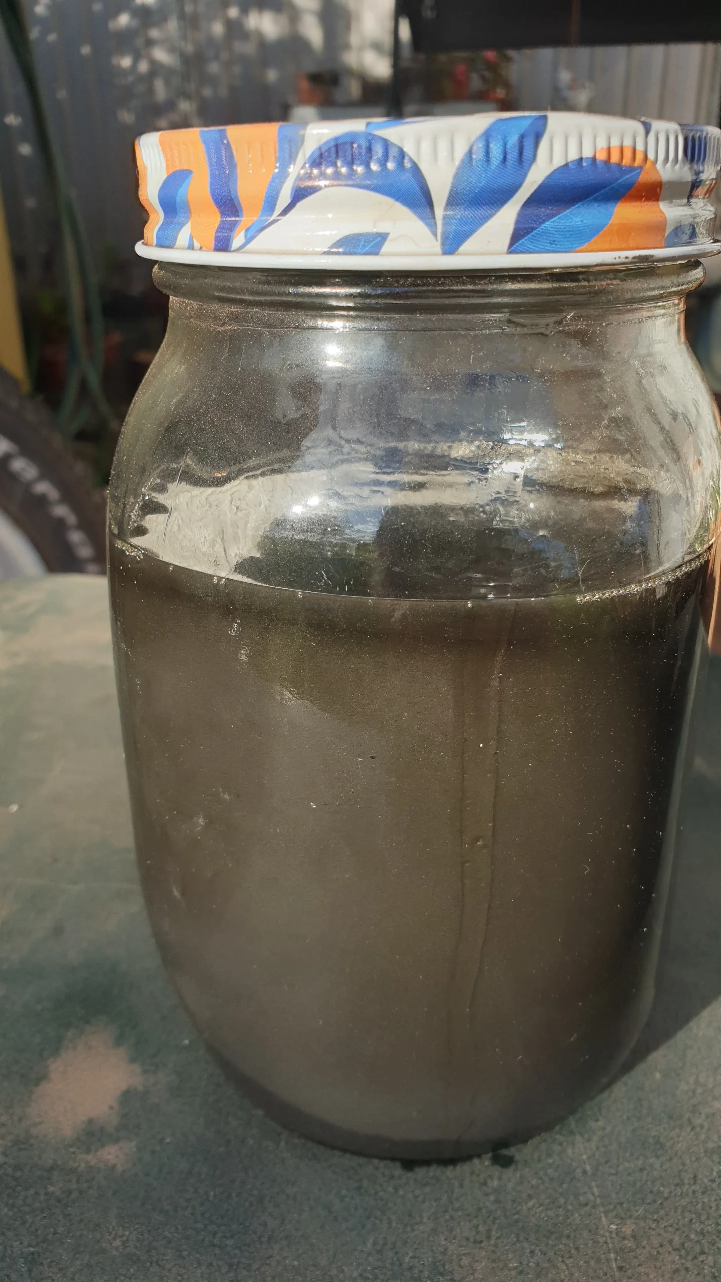

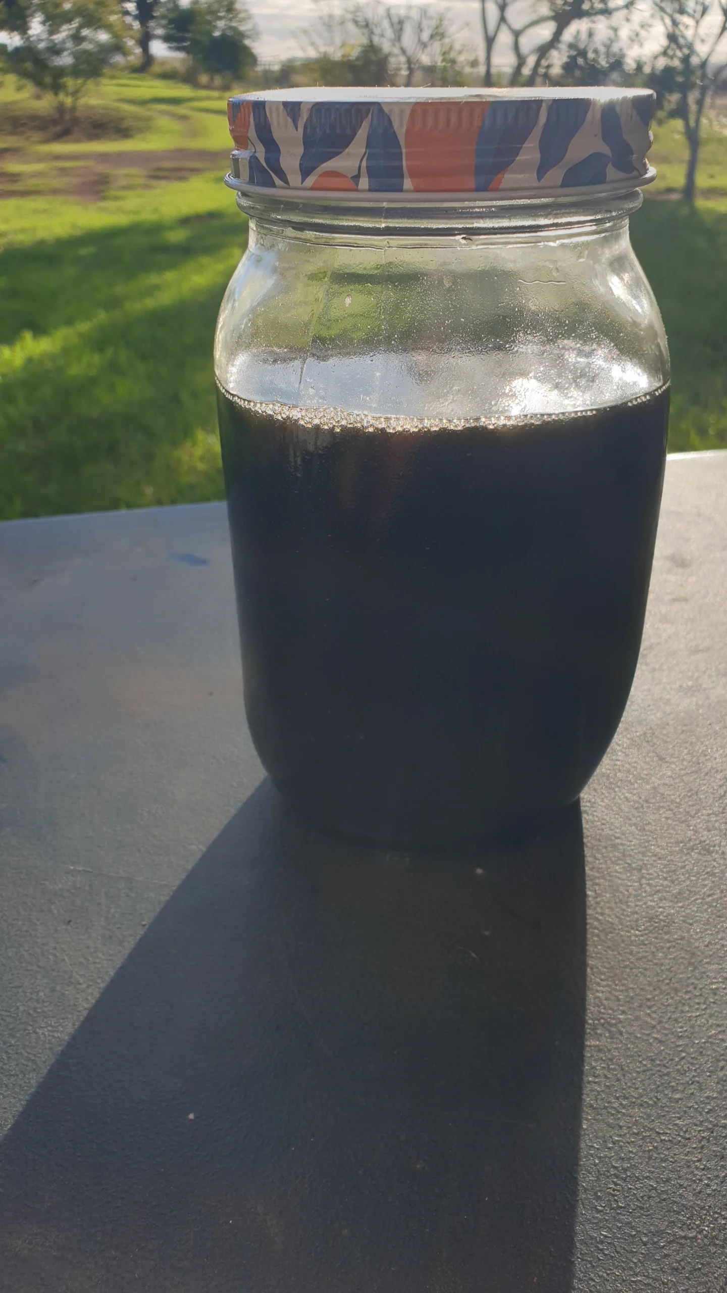

I had the GRU oil changed a week or so back by my local mechanic, using his four-post hoist (cost A$30!, using my oil). The local(?) (120km away) H dealer took a sample at the last service and I didn't like the look of it. I collected the old oil in a clean Alfoil tray and poured it into a clean glass jar. Please see photos. With full sun shinning on the jar it looks a metallic grey colour. With strong sun behind it, looks quite opaque.

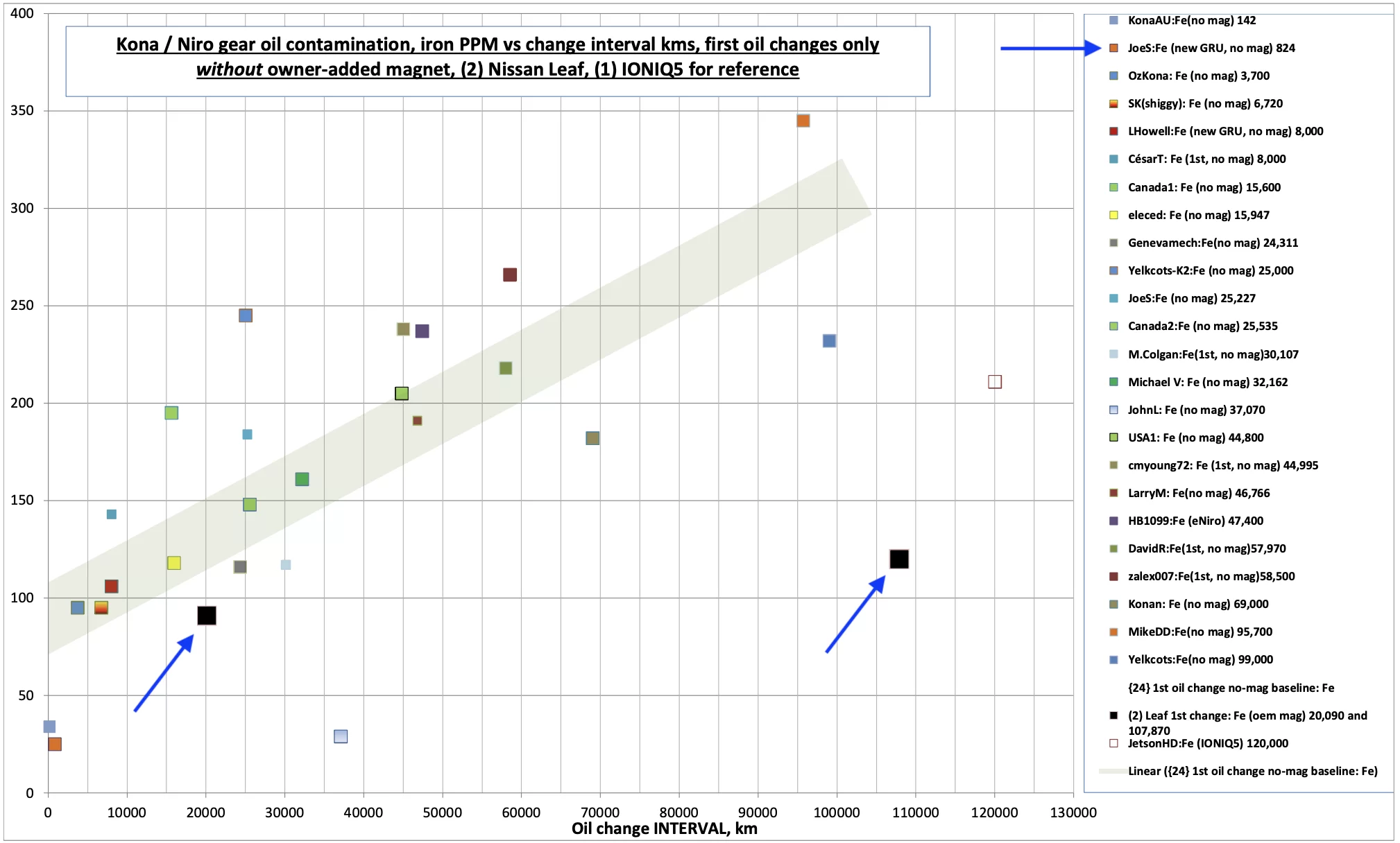

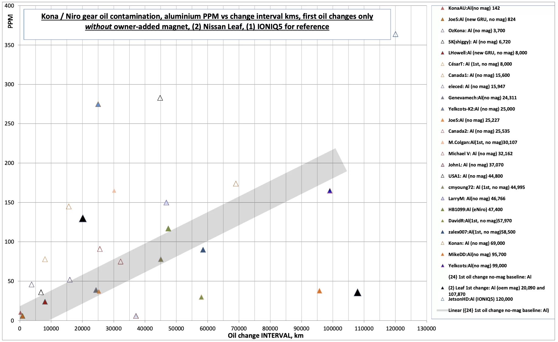

For the record here are the current graphs of iron and aluminium content that I've been updating for many years. You also hold the record for the least-expensive non-DIY oil change. The most expensive was NZ$450.
Wow, that's great info, thank you. Have you come to any conclusions on OK Vs Unacceptable levels? And do any of your any samples relate to vehicles that subsequently had a GRU replacement?
When Brian (mechanic) said 30 bucks, I couldn't believe it. He and his off-sider (apprentice?) spent over an hour on it. Partly due to taking a punt and removing the rear plastic cover first... I think it may have been their first opportunity to have a close look under a full BEV (not that many here yet in rural SE Qld. - but improving since fuel prices took off thanks to you-know-who!)

The two Leaf UOA included for reference are where we should be, under 150 ppm. Nissan used a fixed magnet on both plugs, one correct way to design and implement particle sequestration.
One datapoint is for a replaced GRU. But it doesn't matter as the root problem was never fixed. Note the graph X-axis are kms change intervals rather than accumulated.

So, back to the GRU oil analysis, the results are attached. As you will see, both aluminium (aluminum if you prefer) and iron levels are elevated.
I intend to change the oil again after a 5000km interval to see if the magnets have collected much iron. I'll get another analysis if I can, but unfortunately the service I used last time is no longer available.
234 ppm Fe at 50,400 km places it slightly above the iron trendline. 81 ppm Al is on its trendline, so no surprises for either measurement.
