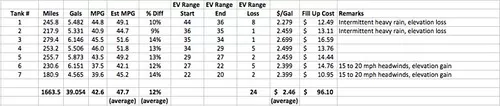

Yes. People are getting 45 mpg in HV mode in the real world - at least in the summer. We've had 12 HV trips with fill ups. We've ranged from a low of 43 mpg to a high of 50. Only 2 were less that 45 mpg.
