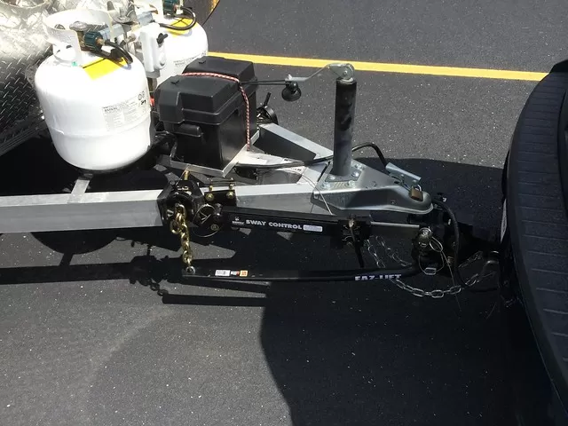

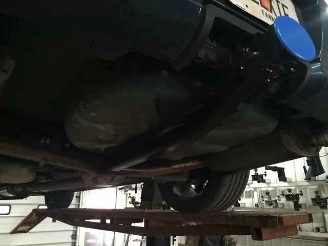

When putting the combo together Ford said 450 lb Max tongue weight. LivinLite said 440 lb tongue weight on our model. Problem was, that must have been without battery or propane or normal loading. When we measured ours loaded it was 620 lbs! The Can Am mod tied the receiver, which had been supported by just the unibody, to the rear suspension.
Towing capacity is listed at 4,500 lbs, which we’re right up against when loaded normally.
But I apologize for the hijack - my anecdote was just to support the drastic effect wind can have on gas mileage.
620lbs would be just a touch high if you’re at the 5,000 GVWR. 10-12% of actual weight is ideal. RV manufacturers tend to publish the lightest weights and then tell buyers they can tow anything with their current vehicle. The 440lb they gave you is about 12% of the dry weight. The only way to know for sure is to hit the scales. If you’re confident that the trailer is around 4500lbs, the tongue weight should be ~500lbs. So maybe some heavy items need to be moved to the rear.
That 620lbs is mostly on the rear axle unless you’re using a WDH. It is also part of the Occupant and Cargo Carrying Capacity calculation for the tow vehicle. More folks than not, an estimated 60%, operate RV set ups that are overweight.
