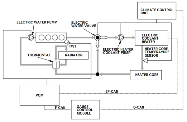

My understanding, or misunderstanding, of the electric heat in the PHEV is that it is similar to an on demand/tankless/instant water heater. It heats the coolant in the engine coolant loop. Per the manual, there are 1.31 gallons of coolant in the engine cooling system.
Under the sink instant water heaters for residential use draw ~1500 watts. They heat water to 149-167F and can deliver 2.5gpm. Coolant temperatures for ICE vehicles seem to be around 185-210F. I don’t know what temperature Honda targets for the coolant when utilized for cabin heat. 150-160F would seem to be sufficient. I can’t imagine what a 7kW or 14kW heating element would do to 1.31 gallons of coolant.
This reminds me of an interesting question I haven't brought up before, but which doesn't affect me. If you use electric heat in EV, doesn't this system waste a huge amount of heat, maybe half, in engine compartment loss? That hot water you're making has to circulate at least a little by natural convection through the radiator, has to heat up the engine block which then loses heat to the surrounding air, etc. It seems like a terrible way to utilize electric heat compared to an inline electric coil in the hvac system.
There's a valve to keep the electrically heated water in a smaller loop when the ICE is not running.
If the engine is cold and you are in EV mode with heat on, there is a valve that isolates the heater loop from the engine to minimize losses.
What does happen in cold weather in HV mode is the electric heater is used to reheat the engine coolant each start cycle to minimize cold run time.
That constant on/off cycling costs gas generated electric energy in cold weather.
As the diagram shows, there is a valve that isolates the coolant in the cabin heating loop from the coolant in the engine. How much coolant is in that loop if there is only 1.3 gallons in the entire system? It can’t take too much energy to heat up such a small amount of fluid, and even less to maintain that temperature. While small, there is some advantage to a bit of thermal mass.
That thermal mass may allow the heating element to have a shorter duty cycle than a pure electric heating element, such as what is in the heated seats. Those are either at 3-2-1 or off. The temperature sensor in the loop would control the duty cycle.

OK thanks gentlemen. Still some losses by conduction, but Honda probably weighed that against the likely longer life of a water tempered heater and the engine heating issue versus a simple inline coil in the HVAC. I probably would have gone the other way and just made sure the coil was replaceable with minimal work. Certainly would have cost less.
If parts of the heating system are shared with e.g. the Accord Hybrid, there might not have been room to put a heating coil directly inline. Or having a liquid coil might be more compatible with the BEV that I believe does have a heat pump. There may be safety or long term reliability benefits in keeping the high current electric coil away from the airflow too.
Hydronic heating is pretty common in home settings -- the house I grew up in and my parents' current house in New England have an oil burner heating water that circulates through baseboard convectors throughout the home. And I had an apartment in CA where the heating system circulated hot water out of the water heater, through a coil in the furnace blower, and back to the water heater. That worked okay for limited heating needs, but you could run out of hot water when showering if the heat was on!
