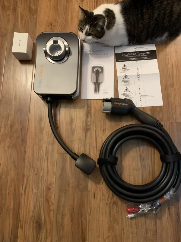

The contents of the Chargepoint box: (and our cat, Oz)

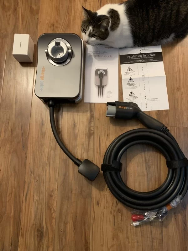

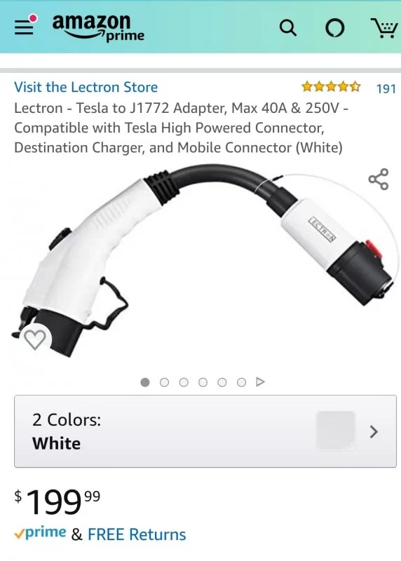

Also, if there are Tesla "destination chargers" around (Level 2, 208 or 240 VAC Tesla *connectors*, usually found at hotels and stores), you could buy and use one of these. (I have one, both to use on the road to give me additional charging options and at home because I have a home Tesla wall connector.):
https://www.amazon.com/dp/B07V7V2QT8/ref=cm_sw_r_cp_apa_fabc_i8gdGbD8PP4T0?_encoding=UTF8&psc=1
Note: This will not work at Tesla Superchargers (DC Level 3 Tesla *chargers*, usually found in banks of 6 or more chargers at highway stops). It can't handle the 100Kw current and doesn't know what to do with the DC.

There are two types of public Tesla chargers. The DCFC Tesla Superchargers that verify that the connected car is authorized to connect and charge (very quickly). Level 2 (AC) Tesla Destination Chargers are available to private establishments who want people to hang out at their establishments while they charge their Teslas. Unlike the Supercharger network, Tesla does not administer Destination Chargers.
As I understand it, these Level 2 Destination Chargers do not check for authorization. Reinforcing that understanding are the available Tesla-to-J1772 adapters that enable non-Tesla vehicles to use Tesla Destination Chargers. That said, I've never seen a Tesla Destination Charger at any private establishment.

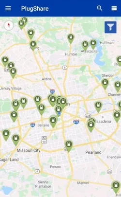

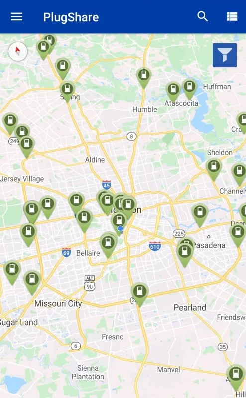

They're all over the place, here in Houston.
BTW, Plugshare is a great app for finding the juice.
That is the app I was using to look at stations in Columbia, SC. On the side of town where I would be staying, there are 9 CSS/SAE plugs:

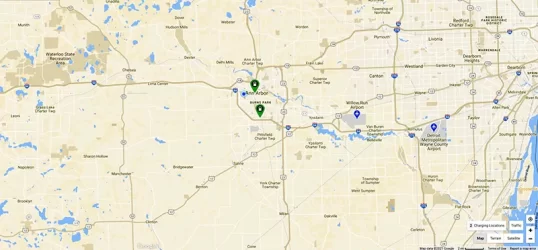

I'm not surprised I've never seen one--I just checked PlugShare for local Tesla Destination Chargers and found there's one in an Ann Arbor parking structure and one at a Sheraton Hotel south of town for a total of 2 in a rather large area (carefully cropped to exclude Detroit, where there are a few more):
