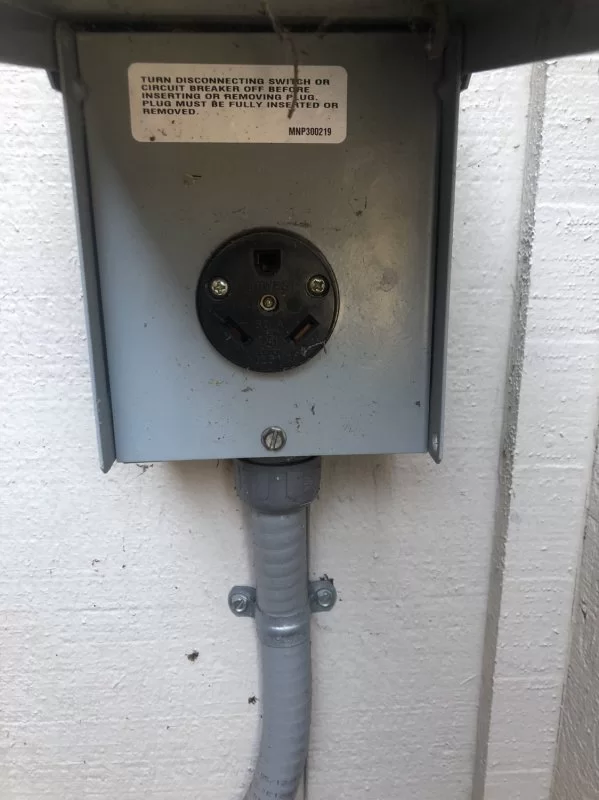

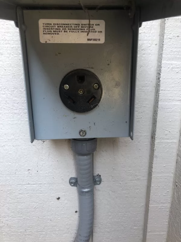

I just got to see my in-laws new house. It’s just far enough away that I wouldn’t be able to drive there and back without charging.
Lo! On the four, I was shown the outlet the prior owner had to power his RV! A 30a outlet!
Now I’m going to consider a cheap, 20a L2 charger since I can easily plug in when visiting!
Now I’m going to consider a cheap, 20a L2 charger since I can easily plug in when visiting!View attachment 11169
Oh, snap.
I just realized that’s likely to be 30a on 120v. Hm. Not sure if that gets me enough, or if I can adapt that connector to the regular L1 charge cable that comes with the car.
EDIT: Oops, my bad. I didn't look closely enough at your picture. It's *not* a 10-30 NEMA plug. :(
What makes you think it's 120V? I have an identical outlet in my house and it's 30A 240V. It's two legs of the 120V going in opposite directions plus the neutral in the middle. You can get something like this:

It's only 16A, so it definitely is below the 80% safety threshold, and since you're likely visiting for at least a few hours this should top up nicely.
Only that it was described as for an RV, and my quick search on that type of outlet suggested it would be 120V. Maybe I can figure it out at the circuit box.
I found that by the dryer plug is actually better in terms of location (it’s in the garage), and I could confirm at the circuit box that it is 2x30a breakers. So, typical dryer plug and 240x30a and that prior recommendation of the $200 charger is golden!
Yes! That's the NEMA 10-30 dryer plug I also have! Let me know how the EVSE goes - I'm thinking of getting that exact model when my car arrives! I have a Home Depot near me so I can return the EVSE in person if it turns out it doesn't work out for whatever reason.
Yeah, I did some searching and it looks like I can get a 24a EVSE for under $300. The trade off is a shorter cable, but the in laws are willing to move a car out so I could pull the SE in and charge, for the rare circumstance that we take that car there.
It likely means I’m buying that EVSE for a “maybe” which is kind of hard to justify. I guess I need to look up the miles added per hour on the regular, L1 cable that comes with the car.
On the other hand, it does seem practical given the ubiquity of the dryer plug. I just don’t know how many places I might go where I’d need it

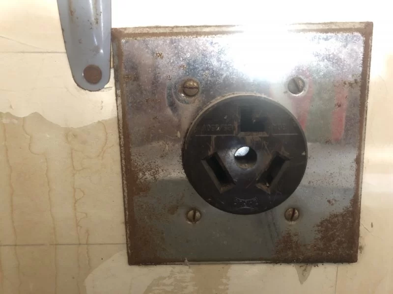

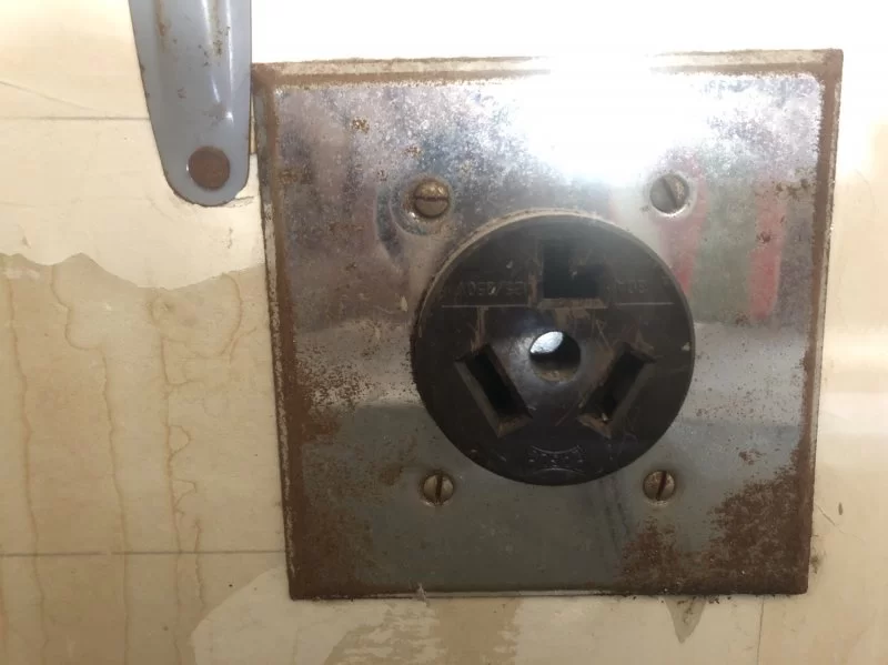

Careful, that looks like a deprecated NEMA 10-30 which lacks a ground. To quote the Wikipedia page on NEMA connectors:
NEMA 10s are classified as 125/250 V non-grounding (hot-hot-neutral), and were designed to be used in a manner that indirectly grounds the appliance frame, though not in the manner consistent with most modern practice.​
Not sure if EVSEs will be happy with no ground.
That’s a great thing to know. Do you think that’s why my dryer outlet is on a GFCI?
