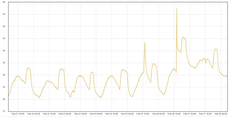

You're the only other person I know who's talked about owning an OpenEVSE. I built mine (from their kit, not from scratch) a few weeks ago and spent some time working with Chris on troubleshooting an extreme temperature issue. Ended up replacing the LCD board which has the temperature sensor. However, I'm still getting what I think are higher than normal temperatures. Here's a graph of the temperature readings (in Celsius) for this past week:
The rounded humps show the EVSE warming up and cooling down over the course of the day, while the flatter plateaus show overnight charge sessions. A couple sharp peaks for quick daytime charge sessions at high current. The temps just seem a lot higher than expected, esp. since the ambient temperature in the garage that the EVSE is located in has been peaking at less than 70 F (20 degrees C) and dropping to about 10 C at night.

That curve looks suspiciously like the temp fluctuation of something that gets hit by a sunbeam part of the day. Is it near a window? You can see a pretty big swing on things that get sun exposure compared to ambient.
The EVSE is mounted inside my garage on a wall that gets Eastern sun exposure in the morning, so the curve does reflect the wall heating up and cooling down over the course of the day. What's surprising is the actual peak temperature indicated by the curve, as it seems significantly higher than what can be caused by the environment. For example, at 16:00 on Feb 27 the sensor indicated a temp of over 37 °C (99 °F), while the ambient temperature inside the garage that day peaked at about 20°C (68 °F). The temperature of the surface of the wall that the EVSE is mounted on certainly didn't feel anywhere close to that warm. And earlier that week when the lowest temp sensor readings dropped to about 21°C close to sunrise, the ambient temp in the garage had dropped to something like 10°C (50°F).
My next step is to put a separate temp sensor in there to check correlations. While the rise and fall of the temp line seems accurate, what I suspect is off is the actual temp calibration. I certainly hope that's the case, as if I'm already getting close to a 60°C temp while fast charging during the day when the temp is 20°C, the device will certainly throttle when I'm charging when the ambient temp is 38°C.

Thanks for the input on something to look into. I can confirm that I have 8-gauge copper wiring for the 14-50 outlet, and the cable for the plug to the EVSE is what came with the EVSE and certainly looks adequately sized. What's more, I'm only charging at the lowest 10Amp setting overnight, and the issue with higher than expected temps occurs even when the EVSE is not connected to the car. The temp sensor is attached behind the LCD display of the EVSE.

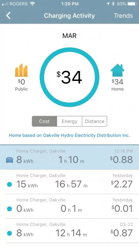

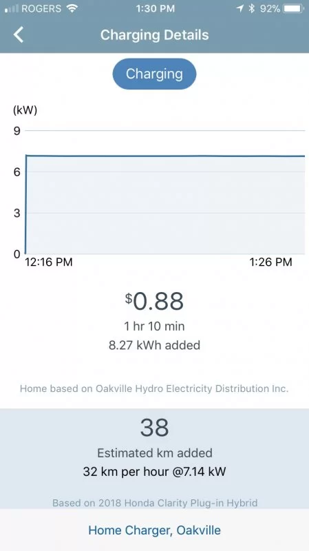

I would also recommend the Chargepoint EVSE, although in Canada they are more pricey, but currently our kind government gives us $500 off the price if you have an electric car. The Chargepoint app gives you lots of data which is interesting as well as scheduling for "time of use" pricing, and reminding you to plug in if you forget to do so. A friend of mine has had it mounted on the outside of his house through the winter and it has had no issues.
