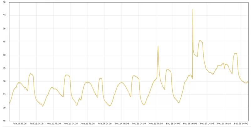

You're the only other person I know who's talked about owning an OpenEVSE. I built mine (from their kit, not from scratch) a few weeks ago and spent some time working with Chris on troubleshooting an extreme temperature issue. Ended up replacing the LCD board which has the temperature sensor. However, I'm still getting what I think are higher than normal temperatures. Here's a graph of the temperature readings (in Celsius) for this past week:
The rounded humps show the EVSE warming up and cooling down over the course of the day, while the flatter plateaus show overnight charge sessions. A couple sharp peaks for quick daytime charge sessions at high current. The temps just seem a lot higher than expected, esp. since the ambient temperature in the garage that the EVSE is located in has been peaking at less than 70 F (20 degrees C) and dropping to about 10 C at night.
Curious if the one you built has the temperature sensor and if you've set up data logging on your OpenEVSE?
