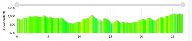

Aaron, I have a very similar drive as you: a couple miles on surface streets in the beginning and the end and 27.4 miles of freeway in between. Drive in EV the entire time and charge for free at work. Here are a couple of things that I have discovered (the observations I list are with open freeways/no traffic):
-you just purchased the car so it will take up to a week for the EV mileage estimate to calibrate.
-Mid to low 70's is perfect weather for the car. Because I have tinted windows and park in the shade I don't use the AC when it is in the 70's and this is when I get my absolute best range.
-Driving at 78 will kill your range quicker than anything else you can do. Staying in the low to mid 60's mph range will improve your range dramatically. Using the Average Speed display on the main dashboard I tried a little experiment. Did this test traveling the same direction (work to home with no traffic) multiple times. If my average speed is close to 50mph it takes about 30 minutes to get home and EV range will calculate around 46 to 49 miles. If my average speed is around 42mph it will take about 33 minutes to get to work and range will be between 52 and 56. For me that translates into driving 65 mph versus 77mph.
-Using cruise control will kill your range by itself. In combination with going 78 mph its even worse. You have more in elevation changes than you realize. When going up a small incline, the CC will work to maintain your speed which uses more battery. Going down a slight incline the car will use power to maintain speed. If you were in control, generally you would not be as focused as the CC to maintain a set speed going up a hill. Going down an incline, you would probably let off the accelerator a bit and capture more regen than the CC would.
-You most likely have more elevation changes than you realize and that makes a huge difference. See pic below. I get about 3-5 miles of range more traveling from work to home (right to left), than home to work (left to right). The elevation change is not that dramatic but does make a difference.
Make some small changes as mentioned above (and make sure your tires are inflated) and you should see noticeable improvements in your range.

Oh wow......this is all part of why I wanted to get an EV. I knew my fellow EVers would be data geeks like me!!!
Thank you so much for this! I can't wait to do some experimenting on my own.
