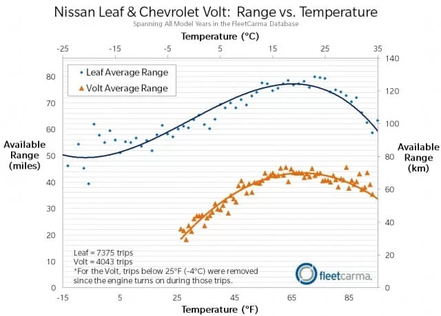

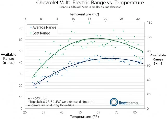

Here's some data on the Volt and Leaf that shows the big hit low temperature has on electric range consistent with what many of are starting to see. I wonder how our cars will behave when temperatures are consistently below freezing and especially during the coldest days of the year if it hits say -30C...brrr
View attachment 2710 View attachment 2711
V8, just don't plan on driving your car if it gets to -30F[emoji2955]
You won't be driving at -30° Fahrenheit. The Clarity Owners Manual says on page 376
If the temperature of the High Voltage battery drops
below approximately –22°F (–30°C), the power
system will not start, the High Voltage battery will not
operate and, as a result, the vehicle will not start.
