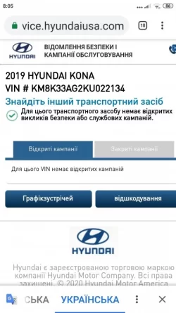

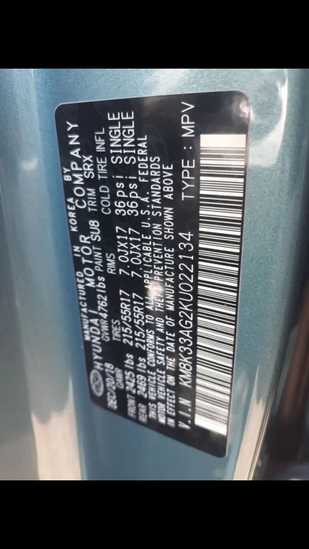

You have an infamous 12/2018 build.Did you post to see if you would need a water pump? I would say yes because mine was done.It's been almost 3 months post my entire pump system was replaced.It only took the dealership about 3 hours max.I made sure they ordered the part before I brought my ride in.

Based on his previous posts I think Igor has a grey market Kona possibly salvaged that was imported into the Ukraine, he likely has zero dealer support.
