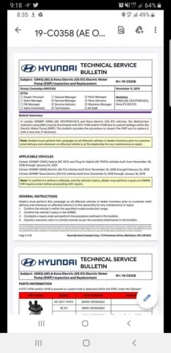

Just had both pumps serviced today on the TSB . Both units showed no signs of leakage so replacement of the can cases and new o-rings was all that was required. Repair time about 4-5 hours . (They will probably get quicker at it since this was their first).
Gratitude to the dealer: first time the coolant has been over the minimum level (about half way between min and max). Was always at min from manufacture.:)
I marked my cold coolant level precisely with a pen in the hope of having a heads-up in case this becomes an issue. I've been able to get my fingers on both pump connectors but the latch is too stiff to open in such confined spaces. Was hoping to inspect them periodically to avoid any down time as parts could take a long time to get to these islands. My build date is 8 Sept 2018.
Stopped by the dealer today and my Dec 22/18 manufacture date Kona is included in the 19-01-036H TSB for the EWP(s), so be good idea to get yours in if close to that build date.
The Techs are aware of the recent campaign however I had to show them that there are two o rings to be changed (one for each pump- Electrical devices EWP and Battery EWP). This part is one they will order and stock, but the pumps themselves or the wiring harness -no .
The procedure is to change the o rings and do an inspection at that time to see if any coolant has leaked into the case or further into the electrical wiring harness connector. If that is the case the pump(s) will have to be ordered and the wiring harness assembly if also affected.
I am hoping that mine has not leaked yet and a simple o ring replacement on both pumps will solve the issue.
I was advised that the job will take close to 4 hours (this is their first one) but once they get good at it -more like 2 hours.
Booked in for mid-January, will keep advised.

This info was posted about the applicable build date range of this campaign, 6 Dec 2018 to 16 Jan 2019.

Best to print out the TSB supplied earlier in this thread and take it to the dealer armed with that info.
