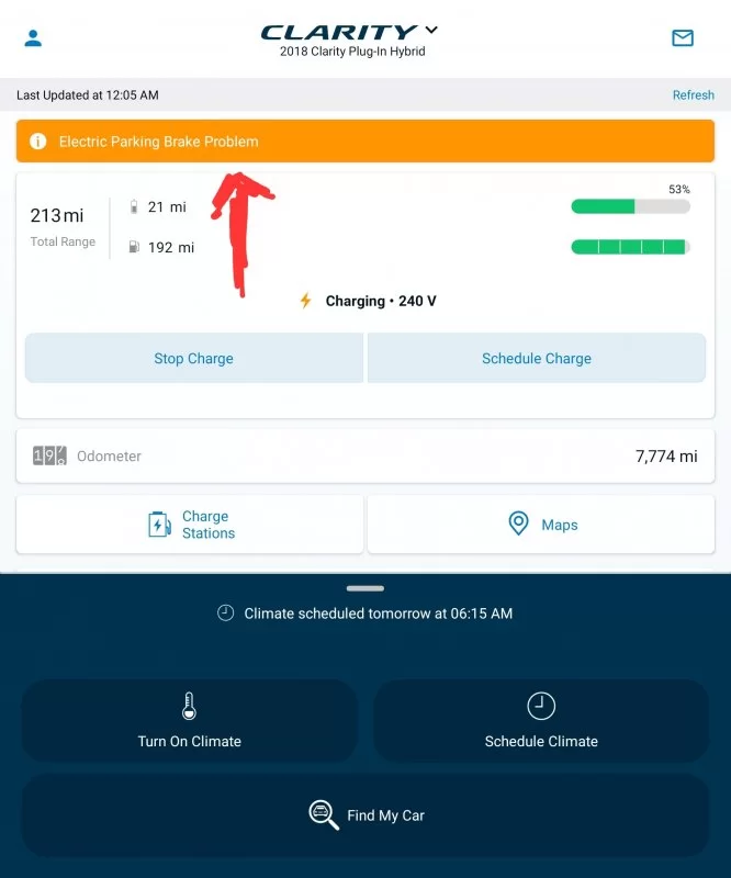

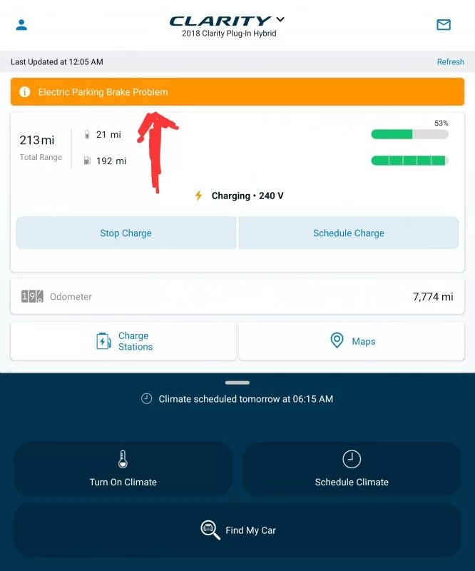

View attachment 14418 Very strange. Out of no where this error message popped up, "electric parking brake problem". But the electric parking brake works fine. Any suggestions what to do?
Don't know what year of your car, but in mine (2018) is the sign of the 12V battery need to replace. So check the battery voltage if under ~12v. Temporary fix is jump start or use car battery booster - goodluck
Good info, will check on that. Mine is 2018 as well. Was gonna take the car to the shop for check up but the error showed up in the app for 2 days and went away. Yep always carry the jump starter and spare tire in the trunk just in case.

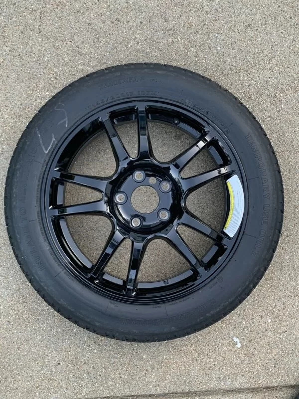

I have the Infiniti donut tire. Which fits PERFECTLY on the Clarity no mods needs it. OEM Clarity lug nut fits right on it.
Unfortunately, the Infiniti spare shown in the pic above above comes with conical lug nuts and the Honda uses ball lug nuts. I copied these descriptions to help:
"Conical wheel nut feature a straight taper at the seat area. Conical fasteners are also called “tapered” or “cone” types.
Radius seats are also called “ball” or “rounded” seats. As the name implies, the seat features a radiused “ball” shape that nestles into a ball-shaped pocket in the wheel.
The golden rule, when discussing seat styles, is extremely simple: Never mix them! If a wheel is designed for conical 60-degree seats, the only fastener seat style that can be used is a 60-degree conical type. The same rule applies for radius and flat seat styles."
So you really should get a set of 5 conical wheel nuts to use with the Infiniti Spare.
BTW, not all of the Infiniti spares use conical lugs. I've seen a few with Mag type lugs (same with the Nissan Wheels).
Also, the Infiniti wheel in the pic fits a 66.1 mm hub. The Honda wheel fits a 64.1 mm hub. You really should use hub centric ring adapter of 66.1 mm to 64.1 mm with this wheel.

Hmm, I see what you are saying but fit perfectly fine with OEM Clarity lug nuts. Drove around the town no issues so far.
Correct, you do need hub ring but I've seen people using it without any hub ring.

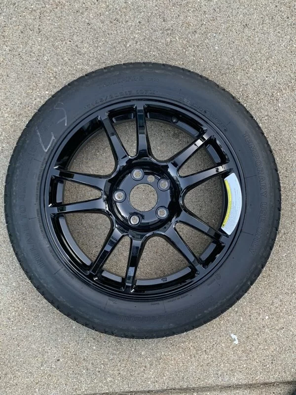

This the hub ring on my Infiniti spare donut tire.
Amazon link: https://www.amazon.com/gp/product/B00AAOEKCK/ref=ppx_yo_dt_b_search_asin_title?ie=UTF8&psc=1
Just because you can do a thing doesn't mean you should do a thing. I wouldn't trust driving far or fast with the wrong lug nuts on the wheel. I'm not as strong on the hub centric adapters, but it seems that the wheel should mimic the OEM fit, so I made that happen with aluminum hub centric adapters JB- welded to the aluminum rim so that the wheel fits flush on the shallow hubs of the Honda, just like the OEM (Nissan and Infiniti have much deeper hubs and fit "deeper" in the wheel). You are right that there are all kinds of opinions on the "need or worthlessness" for hub centric adapters.

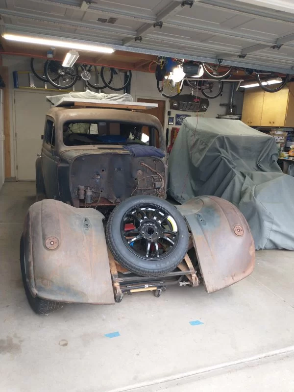

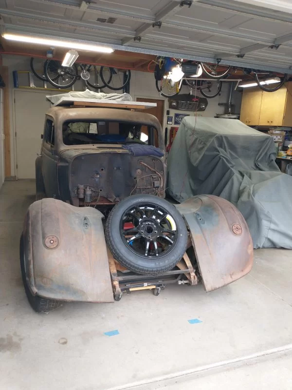

It has no engine, therefore I assume you plan to electrify that thing ?? :rolleyes:
LOL! Actually, some people have done EV-powered street rods. I considered that option but both the cost and the skills required are WAY out of my league. The current plan is to complete the build (a 1936 Nash Ambassador) completely on my own, working out of my garage -- this will allow me to learn many new skills (e.g., body work) and help keep costs down. I already have a donor car for the drive train swap (a 1997 Suburban), and the Nash currently is sitting on independent front and rear suspension (from a 1979 Jaguar XJ-12). It's literally sitting on it -- I was getting ready to fabricate the front suspension brackets when the project stalled out due to health issues, and then the pandemic. :confused: If I don't get back to it within 10 years, maybe I'll use my wife's Clarity's drive train for the donor! :eek: Most likely, however, I'll decide to stay married to my wife. :D
