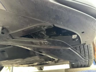

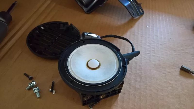

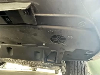

To do this I took the speaker cover off:
index.php
and found the speaker to be a simple paper cone attached to a voice coil. I then packed it full of insulation:

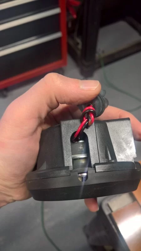

Yes, that is essentially plan C. I took out the speaker again and pulled to boot off to confirm that it was just a speaker.

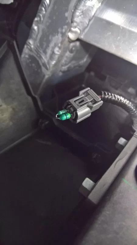

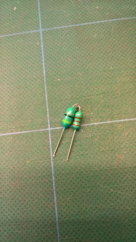

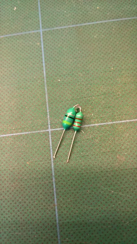

Then I measured the resistance across the speaker and found it to be about 3.75ohms. I don't have an LCR meter so no idea about the inductance. I didnt' have any 3.75ohm resistors so I put a 2 and a 1.5ohm together for about 3.8ohms.

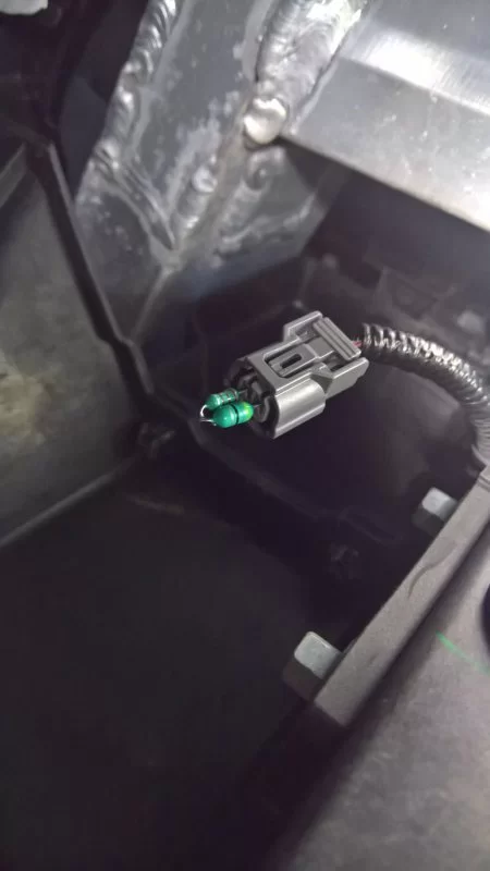

I then stuck it in the connector, turned the car back on, then drove up and down the driveway a bit. The warning was gone and didn't pop back up after I left it in for about 10min!

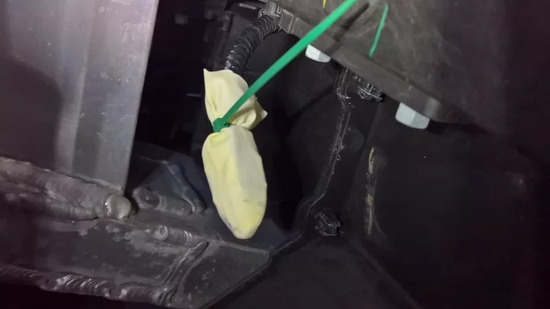

With that I put some electronical tape on the connector to hold the resistors in, put the boot back on it, and we'll see how long it lasts.

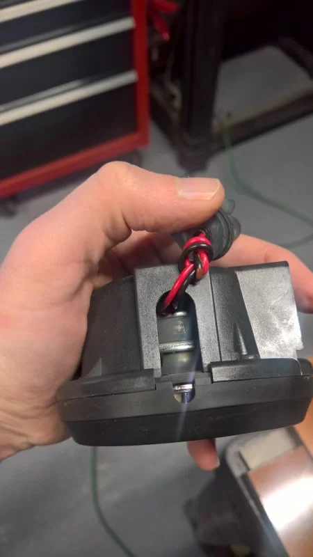

But still, the easiest solution is what was described above, to install a resistor at the speaker unit, and somehow waterproof it. 4ohm is a common speaker impedance. You may need a higher-wattage resistor. I'm not sure how much power the acoustic system would try to pump into it.

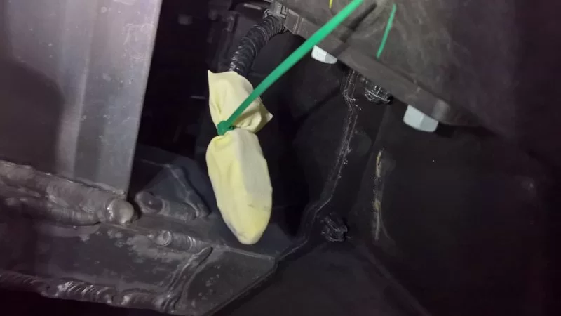

Actually pretty easy to reach in / unplug n' plug. All clips right of the silver bolt had to come out to be able to pull the plastic and get to the rubber 'speaker' cone. I then zip tied the adapter to that rubber cone.
