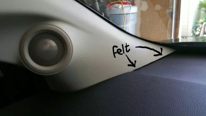

Thanks to this forum, I was able to determine the source of my buzzing noise as the driver's A pillar trim. There was a narrow gap at its base where it meets the dash, and the two pieces were vibrating. I stuffed a 1/2 inch wide length of black felt into the gap and the buzzing noise is gone! I'm going to do the other side just for good measure. Photo of my work included. View attachment 1295

I had this rattling at low speeds on uneven pavement, passenger side pillar.
I pushed a couple of pieces of soft foam using a small screwdriver and managed to provide enough support so the pieces are now even.
From the many posts on our forum, there seem to be 4 areas reported as noise makers.
1 rattle in the A pillar mostly related to the tweeter grill and aasociated parts
Helped by foam tape.
2 rattle between A pillar and dasboard where they meet. Also helped by foam and foam tape.
3 dashboard rattle caused by defective fan motor and blower. Fixed by replacing fan motor and blower.
4 wind noise from the from small triangular glass window at A pillar not being installed and/or sealed correctly. R&R fixes it.

The best you can do is to inform the service advisor that there are several posts on this forum about it so it is a common source of a rattle. Also you could show him or her that pressing the pillar with your hand can make it go away. All it needs is some foam or foam tape.

When it's happening, try putting your hand on the windshield pillar near the little speaker. If that doesn't stop it, try pressing gently on other areas at the edges of the dashboard, especially the seam where the windshield pillar trim meets the dash top. If you can stop it, your dealer, or you, can try stuffing short lengths of felt or foam in various places. I think everyone here has fixed the problem this way.

I popped off the A pillars and fixed the speaker rattle. Easy fix really...and I do say thanks to the folks on this board for the heads up...those rattles can be hard to locate. Info like this really helps new owners out.

Tangible: My Clarity is now silent as can be....I did not require any parts. I did the A pillar work myself and between a couple pieces of double sided tape and some self stick foam insulation at the base of the pillar...been silent for over a month. Really not that big a deal to fix.
