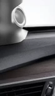

The source of the rattle appears to be the baffle in the little speakers above the dash on both sides. Tap on it and you can hear it rattle. While driving, push on it when rattling. It stops rattling.

This speaker. Driver and passenger side.

Grill on the speakers on the pillars above the dash appears to be the culprit. When you hear the rattle, push on the grill. Or, when stopped, tap the grill.
I think you’re on to something. Some quick testing this morning on the way to work seems to confirm that this is the source of my rattle on the left side.
