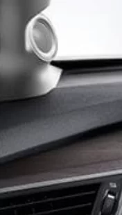

I have the same rattle. On my car where the Dash meets up against the "A" Pillar there is a gap. The two pieces do not line up properly. You can really tell the difference when you compare it to the passenger side which merges perfectly. The rattle stops as soon as I put a slight pressure on that corner. I hope there's a permanent fix for this. I might try the foam as a temp fix.
Brand new car bought 6 days ago and I have the exact same problem. The left side corner of the dashboard is not set properly and is hanging below the end corner of the A-pillar. I was not expecting this kind of "fit-finish" miss from Honda. (Tesla ? Sure !) You press on it and the dashboard goes down. Looks like there had to be a clip or something below which locks the dashboard with the A-pillar. The right passenger side is perfect. Will be posting a picture soon...

Here are the pictures. On the left we see the GAP. Dashboard is not aligned properly. Left side is all good. Sorry for the lack of clarity (no pun intended). The sun was bright and the edge didn't quite resolve in the picture.
I have the gap on the drivers side dash. Took it in to get it fixed, dealer comment was "Hondas are known for this, this isn't a Mercedes!". Of course, my jaw hit the floor. I didn't have time to leave the vehicle again to have someone else look at it. Passenger side is perfect, everything else is as well. Does anyone else have this type of gap?

See my post above with the pictures showing that gap between the A-pillar and Dashboard on the far left corner. Looks like there is solution to that. The rattle got minimized with the Foam tape in the A-pillar. But I can't help to notice the Gap everytime I drive. :(
Thanks to this forum, I was able to determine the source of my buzzing noise as the driver's A pillar trim. There was a narrow gap at its base where it meets the dash, and the two pieces were vibrating. I stuffed a 1/2 inch wide length of black felt into the gap and the buzzing noise is gone! I'm going to do the other side just for good measure. Photo of my work included.
Mine looks like that too, on the driver's side, and when I push on the white part it clicks into place and then pops right back. On the passenger side it is perfect. I don't plan on getting it fixed because it's not making any noise after I put felt in the gap. See my post below.
