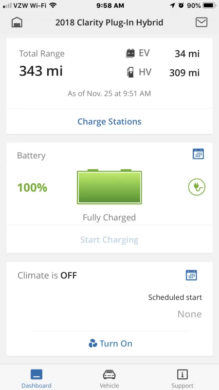

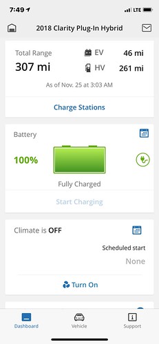

After last night’s overnight charge it’s showing 5 add’l miles EV range (46 vs 41).
I assume that’s typical for it being about 5° to 10° warmer?
Or does it “learn” how one drives? I drove a gingerly 96 miles yesterday in ECON mode. First data point which I’ll post shortly to my thread on”Mission Profile”.
Clearly I’m a lead foot with the battery then! Totally surprised at the poor range this morning:

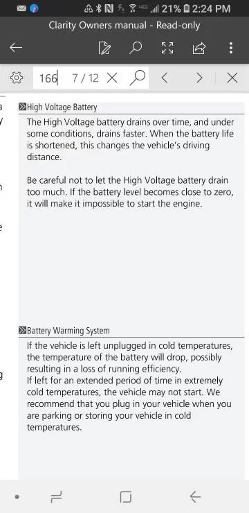

Just in case someone has the experience from last year. The manual and documentation states that at -30C there will be battery issues with starting the car. Not that it ever gets that cold (often), but there may be times where the car is not plugged in (nor can it be) at those temperatures. Does that mean that I wouldn't be able to start the car at all or that it means the ICE turns on and need to drive under ICE while the battery warms up. BTW I'm in Canada so have the battery warmer, but there may be times when I can't plug in overnight and the temps may drop to those temperatures and want to know if I need to wait to start my car after the temp warms up or if I'll be stuck.

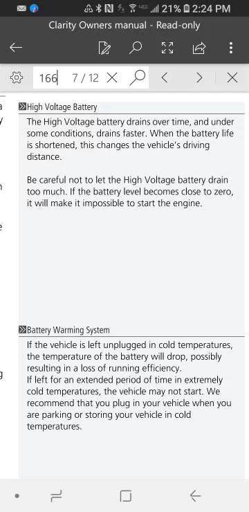

@Kranberry, see page 466 of the Owner's manual. Seems to indicate that if temps are low enough the car may not start. The car, in Canada, really wants to be plugged in in really cold temps.
@Kranberry, see page 466 of the Owner's manual. Seems to indicate that if temps are low enough the car may not start. The car, in Canada, really wants to be plugged in in really cold temps.View attachment 3067
I saw that in my manual already, but wondering what people have experienced. Imagine the temps being around -30 or lower, you go to the mall, they only have outside parking, you are there for enough hours that the battery definitely is -30 or lower and for a few hours, is Honda saying I can't move my car? I just wanted to see if any real life experience out there with this situation.
I don't believe a sold Clarity PHEV has yet seen -30 C, so there probably won't be any real-world experiences to report. Taking Honda at its word, if your battery is -30 C, your Clarity won't start. Your best bet for shopping in -30 C weather is to choose a mall with a public EVSE where you can plug-in to recharge and then get your battery warmer working. If there's already another car occupying that EVSE, turn around, go home, and plug back in.
