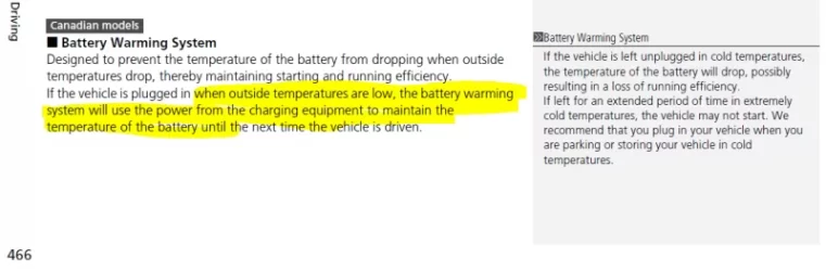

For the Canadian model, Honda recommends the following:
So if you go out on a -30C day and intend to park outside, you need to plug into a charger (tops up the battery then the AC source is used to run the battery warmer) otherwise, run the risk of the battery being too to start the car as the warmer will not draw on the battery to keep it warm.
Personally, I don't have problem as my garage is attached and I have indoor parking at work however, I do feel for our U.S. friends from the northern states who don't have the warmer.
Thank you for finding what I missed in the manual. It appears the battery warmer draws so much juice that it isn't feasible to have the battery warm itself when plugging in isn't an option.

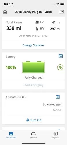

Our battery was showing zero EV miles remaining (as planned) when we turned into our driveway yesterday afternoon after running errands that exceeded EV range and taking it out of HV about 6 miles from home with 6 EV miles remaining. Plugged in and apparently we had a full charge at around 3:14A:
Temperature this morning is 42ºF, which is probably close to last night's low.
Anyway, a little disappointed that 41 miles EV range is so much less than the 48 miles specified by Honda. But from this thread can I assume its fairly typical?
As an aside, I know cabin preconditioning is not supposed to work when plugged into 120v, but yesterday it seemed to when we tried it. Was that because with a full battery, even though we were plugged in, we were not actually charging?
The range numbers quoted by Honda are derived from standardized tests conducted in a lab under controlled conditions. They are essentially an average that the consumer can expect. In mild weather they can be easily exceeded, in cooler temps the range will be much less. Driving style and speed also will move the needle up or down.
