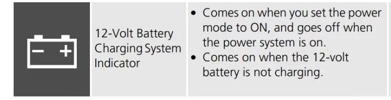

When not plugged in there are three modes available:
ACCESSORY (press power button once without pressing brake pedal). This runs off the 12V battery and powers the infotainment system and the USB and 12V charge ports.
ON (press power button a second time without pressing brake pedal). This also runs off the 12V battery, and powers up the full instrument panel display, the power windows, the DRL's, and also runs the fan, although no AC or heat since they require the HV system which is not active in ON mode (although the 12V seat heaters work). As a side note, many people have inadvertently drained their 12V battery by sitting in their car in ON mode without realizing it, since what is seen on the instrument panel in ON mode is very similar to READY mode, with only a few subtle easy to miss differences, the main one being the absence of the READY indication, but also the EPS (electronic power steering) warning indicator appears:
And as I mentioned the red battery icon is displayed, indicating that the 12V battery is not being charged
READY (press power button while pressing the brake pedal). The HV system is powered up and the car can be driven (and AC and heat are available)
MODIFIED ON (my name for it). If you are plugged in when you press the power button twice without pressing the brake pedal, you go into a modified version of ON mode. It looks very similar to regular ON mode, in both versions there is no READY indicator. However in the modified ON mode the HV system is active, you can see an HV amp indication in Car Scanner, and it also shows 14V indicating that the 12V battery is being charged. Equally telling is that the red 12V battery indicator does not appear on the instrument panel.
Interestingly A/C and heat are not available in this mode even though the HV system is active, which is somewhat annoying if you are sitting in your car while charging. While charging all you can do for climate is to run preconditioning, which gives you basically no control of climate, it stops you from using the sound system, and if you are in your car for a longer period of time preconditioning cuts off after 30 minutes, which also ends charging so you have to start it all back up again.
If I try your experiment and have the car already running in READY mode, then I plug in the charger, it goes out of READY mode into the modified ON mode that I just described. One quirk, once it's in modified ON mode, even though it says on the screen to press the brake pedal and the power button to start the car, that doesn't work and it remains in modified ON mode. I have to turn off the car then start it again to go into READY mode.
except the 'blue' part of the dash will turn white indicating that the traction battery is offline so you can't drive it
I don't think I would say it indicates that you can't drive because it's the same as what is displayed in HV mode. The indication that you can't drive is that READY does not appear on the display.
