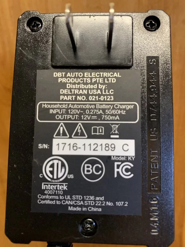

Below is a photo of the same device from my collection. Another way to measure the charge that was applied to your battery is to multiply the output by the hours. In this case, .75A x ~8 hours = 6A. Not much after sitting for a week, given that LA batteries typically self-discharge 10% per month with no loads.
The above formula assumes the maintainer is operating at maximum output, I do not know if the output is variable as it is so minuscule even at max. Interestingly, it shows an input of .275A at 120V which equals 33W, and your meter measured a load of only 13W.
The 13w May include losses/overhead by both the tender and Wemo. It is variable. I have seen values between 5w and 13w. Smaller batteries and fully charged batteries are cases when I will typically see lower values.
