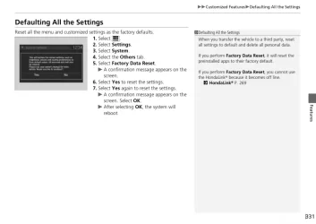

This may be a shot in the dark, and study carefully what it resets first:

I had another instance of no XM radio after preheating the car. This does seem to be an inconsistent issue in that sometimes we can preheat and still have the XM radio function while returning to the car.
However this time, with no XM radio, I held down the radio power button to reboot it, and that worked. This was while driving, so this does seem a preferable alternative to pulling over, turning the car off & on.
