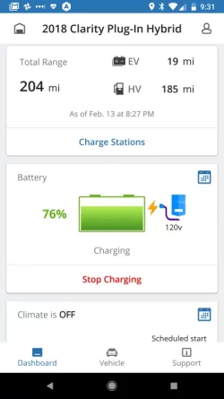

How come the app is no longer showing the amount of time to a full charge?
Is this a new "upgrade" in the app?
On mine sometimes the app does and sometimes it doesn’t. It’s always been like that, so I tend not to rely on it. I know a full charge will take about 2 hours and 5 minutes.
