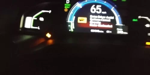

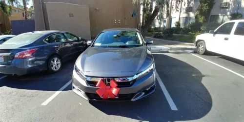

***HELP*** I have a Clarity plug-in. As I was returning from a road trip the following message " some driver assistant systems cannot operate radar obstructed" came on the dash. I took it to the dealer the next morning and of course the message went off. The dealer calls and informs me the "H" was scartched by the bow (yes I had a red bow like the ones you hang on a door or car for the holidays). They blame the scratches for the failure and refused to look into the issue further. I have not seen these scratches yet as I am due to pick up the car tomorrow. The H infront of the car is going to have wear and tear as it is infront of the car. It does not make since for the "H" to have to be pristine in order for the senors to operate. Furthermore, if these "scratches" do infact impare the operation of said sensor wouldn't the message still be on the dash??? Any helpful input would be most appreciated. Oh and for all those who are interested I was quoted a price tag of over a grand to replace that darn H, and they said that I would have the H replaced before they would investigate the senor issue if it were to occur again

That bow isn't even on the H, it is below it. Maybe try a different dealer? If ever you needed a second opinion, this is it.
I wouldn’t want this dealer working on my car!
Totally agree, crappy dealer.
But, one thing to check is did the bow have a metal backing or substantial metal clip, or was there wire holding it on. I have not looked at where the radar antenna is, but any metal in the vicinity of the radar antenna might cause system problems.
When the Volt ACC models first came out, one of the oddest failures was caused by metal license plate frames. (I think I see yours is a plastic dealer frame, just a note of possible metal items to watch out for.)
