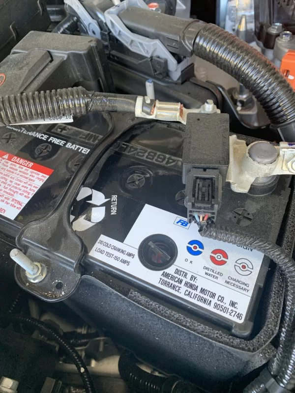

Did you happen to measure the voltage before you started? Or while the car was on?
Ideally you’d want to wait about an hour after charging to get an accurate resting voltage.
We must have different batteries as mine will apparently throw up a white flag when charging is required and a red flag when water must be added to the “maintenance free” battery.
Same battery. I misremembered the colors. I'll bring my meter with me next time.
Tomorrow we return to the house where the Clarity has been garaged, unplugged, since March 14th. The first step will be to measure the voltage on the 12V battery.
Good luck! I, for one, am looking forward to your battery voltage report. Hopefully, there was no parasitic activity and your Clarity will pretend you never left town.

After 6 months the battery was completely drained. It metered 1.1V. I checked it several times. The other car (Jeep) battery was 12.6V after the drive today. I even checked a few AAA batteries that metered 1.8V.
I connected the NoCo lithium jump pack and the horn started honking. Disabled the horn, started the car, disconnected the jump pack and metered the battery at 14.6V. The car remained powered up while I checked the pollen filter. Perfectly clean.
After letting the HV battery charge the 12V battery for a few more minutes, I took the car for a 20 mile drive in EV, mostly freeway at 65-70mph. The idea being to give the battery some more charge time and to drain the HV battery a bit so I could plug in and charge up both the HV and 12V for a few hours. The battery metered 12.7V after the short drive and 13.3V after the charger was plugged in.
I left the car with the HV battery fully charged. It was charged on Friday, 3/13, with the expectation of going to work on Monday, 3/16. Yes, I know, storing the battery fully charged isn’t recommended. The gauge showed that it was still fully charged. EV range showed 37 miles.
Tomorrow I have a 44-45 mile round trip planned which will be attempted in EV. I’ll follow up tomorrow with info on whether or not the car starts in the morning, how much EV range is achieved, if I get a new battery, etc.
Welcome back to your Clarity! It's good to know the DC-to-DC converter charges the 12-Volt battery when the Clarity is plugged in, even if the Clarity is not turned "On."
This morning the battery was at 12.6V with the L1 cable still attached. The green charge indicator light was off, so I suspect that there was no charging voltage being applied to the 12V battery. Voltage remained at 12.6V with the cable disconnected. I don’t know, if, when, how, 12V charging occurs once the HV battery is charged and the car is parked with the cable attached. The light was off, so I’m going with “nothing was happening”.
Temp was 68F, EV Range showed 43. I drove 44 miles in EV. Roughly 40 of those miles were on the freeway at speeds between 50-75mph. The other 4 miles were on surface streets. Remaining EV Range showed 3 miles.
All in all, I’m pleased that the car covered 40 miles at high speed, plus 4 miles on city streets and had 3 miles remaining. It seems the EV Range estimate needs to relearn my driving habits. Yesterday it showed 37, this morning 43, tomorrow I expect to see upper 40’s. For the moment, I’m convinced that leaving the HV battery fully charged for 6 months caused no harm.
The most perplexing aspect is that the battery was down to 1.1V. That just doesn’t seem to follow a normal discharge rate for a 12V flooded battery. Particularly, after it was previously left to sit for a month and the voltage was 12.45V. The doors did not unlock automatically, the anti-theft device indicated that it had lost power and needed to be reset. I metered the battery a few times and tested the meter on several other batteries to confirm proper function.
What is also interesting is that the battery seems to have recovered, which seems nearly impossible from such a state of discharge. I recently attempted to revive a motorcycle battery that was down to 7V with no success after a week of repeated charges. I don’t plan to repeat this test, so some things may remain mysteries. I’ll update if the 12V battery fails in the near future.
