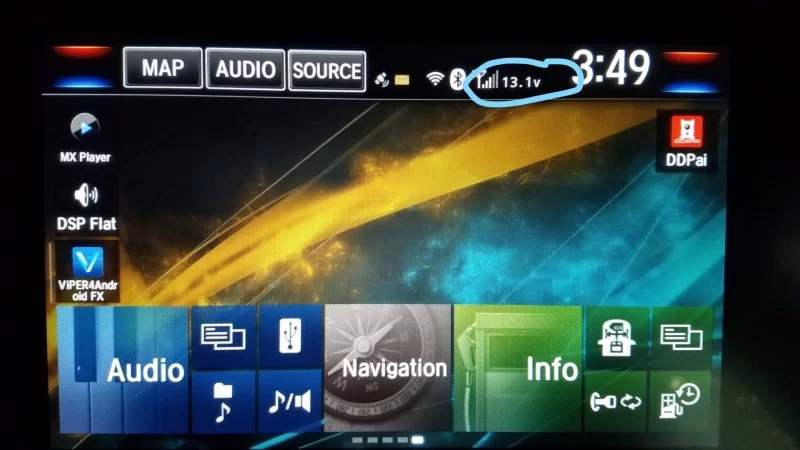

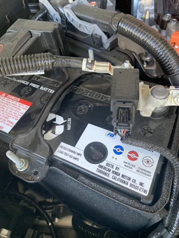

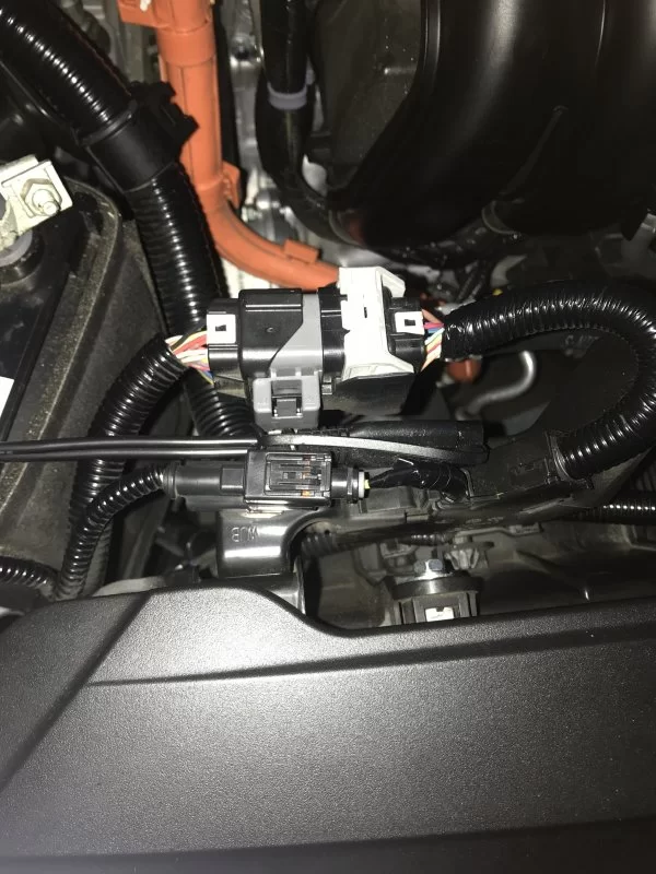

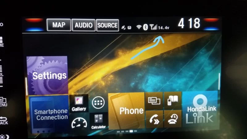

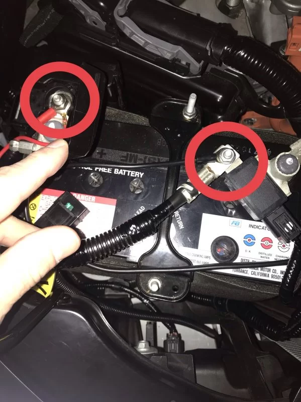

Manual pages attached. You can also hack in cool 12v battery monitoring things like this (one in vehicle ON, one in vehicle accessory while plugged in charging).

Can I assume that the 12V battery voltage shown on Cash's center display is a feature of Honda Hack?
