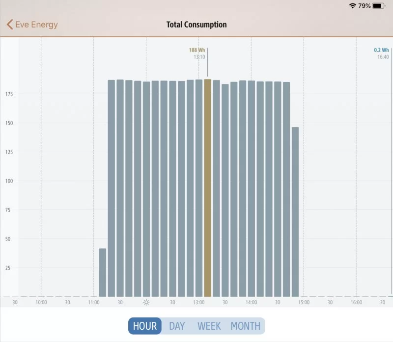

When I was doing Level 1 charging I successfully used an Eve Energy smart plug, and had no issues with power draw. I'd think any number of smart plugs would work.
A bonus was being able to track consumption.
