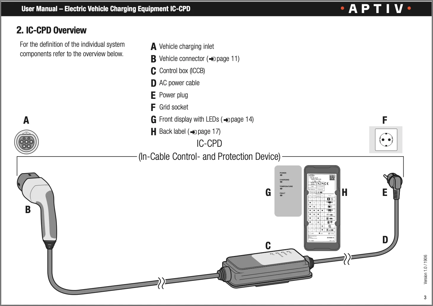

Except the Flexible Fast Charger is an EVSE indicating a "mode 3" charging scenario, no idea what an "IC-CPD" is.
The manual for the flexible fast charger is titled "Flexible Fast Charger (Mode 2 Charging Cable)"
What they label "ICCB" (in-cable control box) on page 8 is what makes the setup an IC-CPD (in-cable control and protection device).
And this manual for another Mode 2 charging cable is more explicit in describing "ICCB" and "IC-CPD":

IC-CPD is the safety and current control electrickery in the EVSE box. There to prevent fire and electrocution. I recommend leaving it alone...

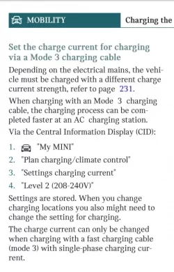

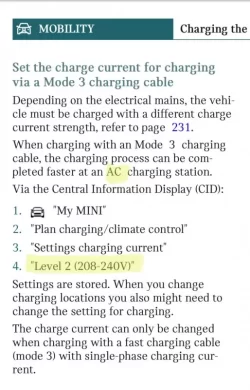

Why are we still discussing this? The OP is driving a '23 and the owner’s manual is pretty clear. @MrSnrub posted a video with clear directions that follow what the manual says. Why are we still discussing this?

I replied, trying to explain that ‘Mode’ and ‘Level’ describe different things, that IC-CPD is not like GFCI, and that the flexible fast charger is actually an IC-CPD.

“Level 2.” That’s all the info the OP wanted. And it’s right there, as @insightman so eloquently pointed out, “in TFM,” easy to “R.”
