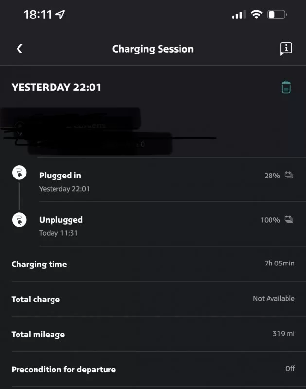

The data is there, it just doesn’t show how much energy was used.
I did do a manual precondition just before we left home and it was still plugged in to our EVSE but the figures stated above were taken before that. I don’t know if that manual precondition messed up the data in the Mini app. Screenshot below.

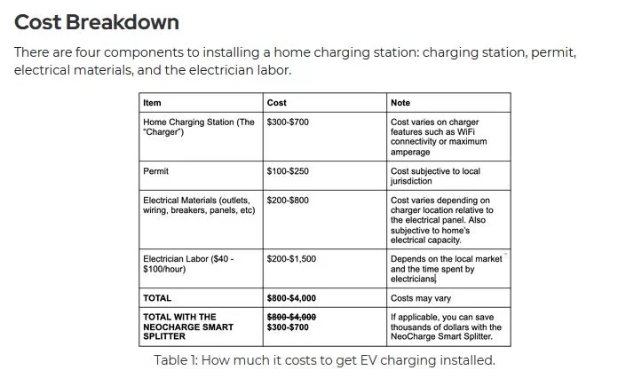

Costs to install depends on complexity of the electrical systems. Taking from Neocharge's article:
This does not include the price of a main panel upgrade from 100A to 200A but shouldn't be a problem since you already have solar.
