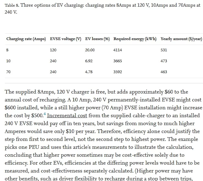

The losses will be nominal if it's all new (copper) wire and a relatively short distance from the main panel. You could read up the 2017 BMW MiniE tests on bi-directional charge/discharge losses:
https://www.sciencedirect.com/science/article/pii/S0360544217303730#sec3

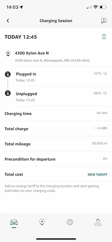

I still can't understand how this is being calculated. Maybe someone can illustrate with actual numbers? Here's my last (level 2) charge session (outdoors, temperature -3 ºF).

Sure, you charged 14% of the battery (66% - 52%), and it used 4 kWh of juice. 14% of the total battery is 4.046 (0.14 x 28.9). The efficiency is 4.046 / 4 = 101% efficiency. Your house is magic!
