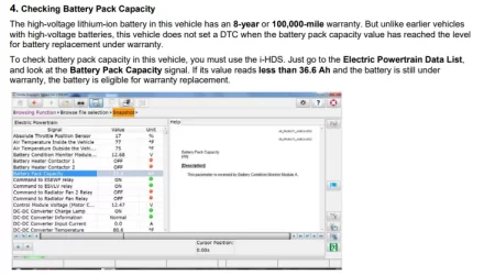

I disagree. Honda has stated that if battery capacity measures below 36.6Ah (and is still under warranty), then it will be replaced free of charge. Such a level of battery capacity reduction would be abnormally high for 8/10 years of regular use, but it is not total failure.
So yes, the warranties do cover degredation, but it is unlikely that you will ever reach 36.6Ah under warranty if you have a healthy battery.

I should clarify that the minimum federal/CARB warranties do not specify what constitutes "failure", and individual manufacturers are free to include or exclude degradation however they choose.
All the documentation I have seen from Honda shows the 8/100 number for the degradation warranty, even in the Section 177 States where the minimum failure warranty is 10/150. I have the BEV so don't have the PHEV warranty book for a CARB State.

"Greater-than-normal degradation is covered for 8 years or 100,000 miles, and can be determined by an authorized Honda Clarity Plug-In Hybrid dealer."

To the point of battery capacity. The easiest and most accurate method it to have a Honda dealer perform a battery capacity test.
